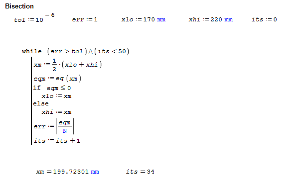

Here's a transparent, home grown bisection routine that does the job:
RC_forum_nonlinear_b.sm (79,46 КиБ) скачан 1556 раз(а).
