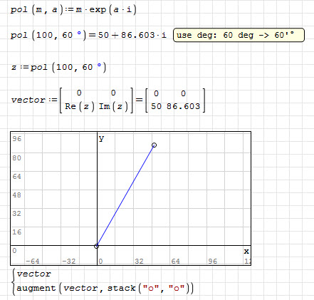

#2 Опубликовано: 27.05.2022 13:57:54
You can use this method
#3 Опубликовано: 27.05.2022 20:25:23
Joseph Lo
Joseph Lo
Thanks uni for that. I tried it and it seems to work - but is it possible that i don't key in the "degree" sign and still get the same result? i.e. the polar form of 100/_60deg = 50 + j86.6.
If I dont put the degree sign it will return -95.24 -30.48i which is a different result.
Thanks

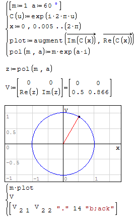

#5 Опубликовано: 28.05.2022 13:24:22
Plot the circle as well.
#6 Опубликовано: 29.05.2022 01:43:42
Joseph Lo
Joseph Lo
I tried it and it seems to work - but is it possible that i don't key in the "degree" sign and still get the same result? i.e. the polar form of 100/_60deg = 50 j86.6.
Thanks! that works well.
Interesting thanks for that. I will experiment with that.

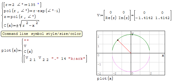

#8 Опубликовано: 29.05.2022 08:36:55
You can have it Class Room style.
Cheers from Up There to Down Under ... Jean.
