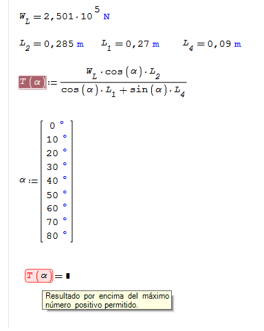

Hello Guys, i've been trying to do this in several ways, but i cant figure out how to make it works.
I'll add a screencapture.
Thank you very much in advance.

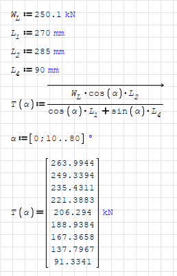

Use vectorize, since α is a vector

Thanks!!!
