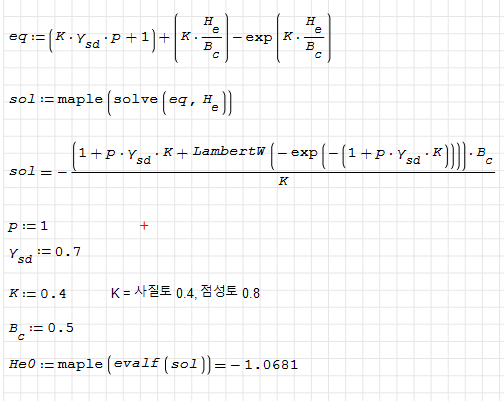

i want to solve this eq.
He0 = ??등침하면의 높이.sm (6,22 КиБ) скачан 415 раз(а).

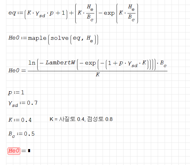

Hi. It's a function that Maple knows, but SMath doesn't. I suppose the most practical solution is to ask Maple to evaluate it numerically, once the parameter values ​​are known. evalf is for "eval with float point".
등침하면의 높이.sm (6,74 КиБ) скачан 427 раз(а).

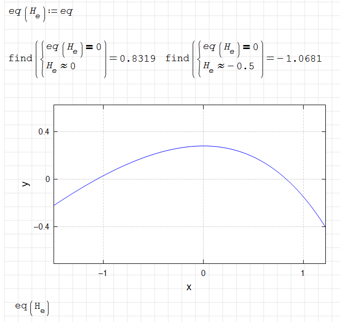

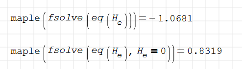

If you plot eq as a function of He you will find there are two solutions: one close to He =-1.068 and another close to He = 0.832 (for K = 0.4).

#4 Опубликовано: 20.05.2026 16:27:01

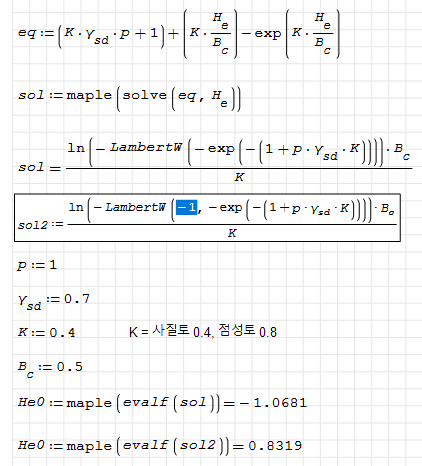

#5 Опубликовано: 20.05.2026 18:58:46
Hi. This is the analytic solution for the positive root, taking another branch in LambertW function, indicated by the parameter -1
등침하면의 높이.sm (7,95 КиБ) скачан 383 раз(а).
