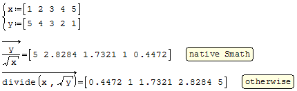

Is there any way to present division on the same line and not as a fraction? For example in Mathcad:

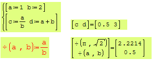

Is there any way to present division on the same line and not as a fraction ?
Maths Infix DIVIDE.sm (4,18 КиБ) скачан 1066 раз(а).
Answer is NO, Smath does not have native ÷ operator
More productive from infix algo style utilities,
for infinite in-situ command line.
infix Divide.sm (3,5 КиБ) скачан 1064 раз(а).
