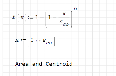

How to find area and centroid
question_20230711.sm (2,88 КиБ) скачан 1354 раз(а).

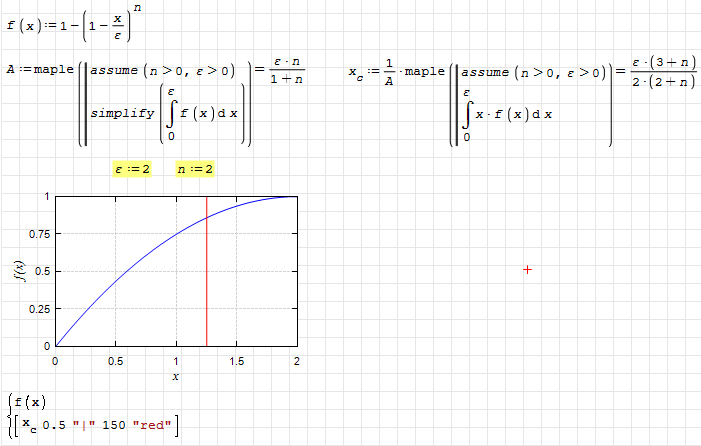

Make your function parametric f(x,e,n), plot some typical.
f(x,0.5,0.5) ... f(x,0.5,2) ... f(x,0.5,3)
Discretize the range(s) of interest.
... suite for: Area, Perimeter, Centroid

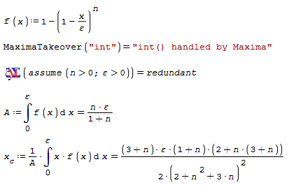

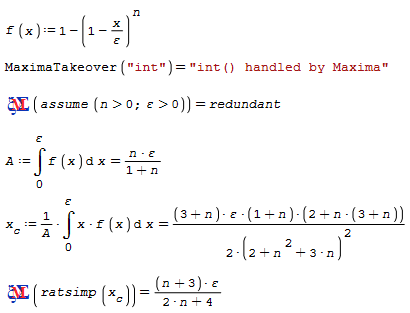

Maxima is a bit lazy with simplification...
Ac.sm (7,08 КиБ) скачан 1301 раз(а).

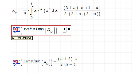

why can't i do right that?
what's the problem?
