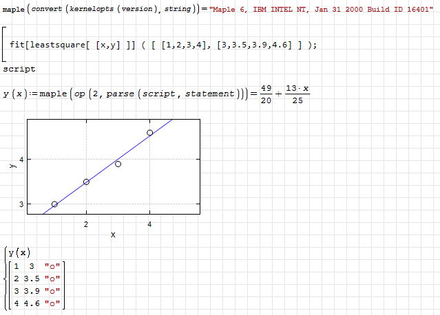

Does anyone know if this maple function works in SMATH? I cannot get it to work.
Файл не найден.
If not available, is there another similar regression fit function available?
Sorry about that. Update to sm file.
I am really struggling. It shouldn't be this hard.
This version of Maple 6 regression fit also does not work.
Maybe someone could give me examples of the five input arguments to the SMATH Fit(5) function as noted in the figure.

It is possible to use this function, but it is difficult. To do this, you need to include the stats package in the with.inс file. By default, not all packages are included in the plugin and you must manually specify the required ones in the plugin folder (bin\with.inc):
with(linalg):with(inttrans):with(plots):with(stats):
Unfortunately, the Maple syntax is difficult to replicate in a document, so the ability to use the symbol engine is limited. I'll see if I can somehow use this solution with vectors from the document. Now I recommend using alternative solutions, which I hope will be offered soon.

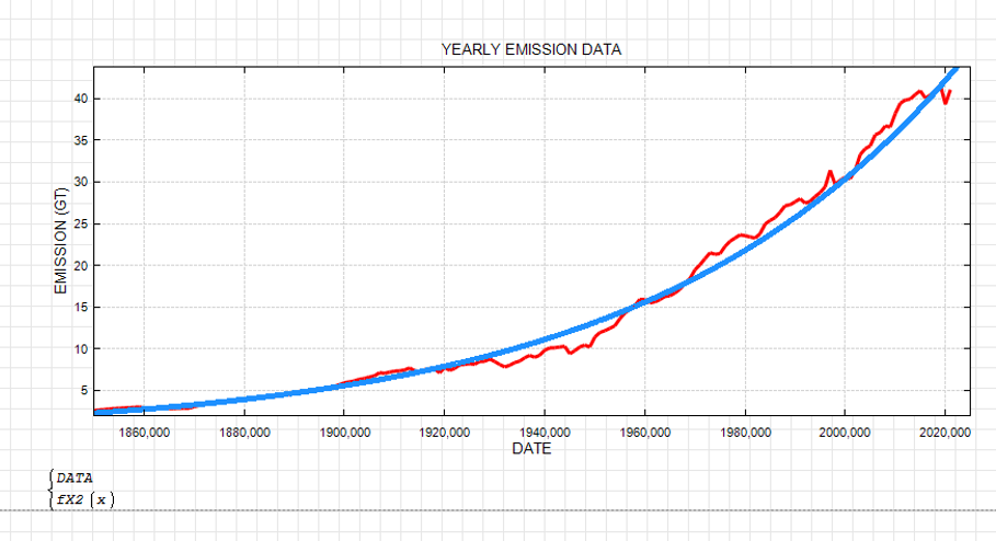

Hi. In the attached how to use Fit(5), which requires Maxima plugin, and al_nleqsolve applied to an overdetermined system.
CLIMATE CHANGE.sm (19,28 КиБ) скачан 1501 раз(а).
About maple, as far I know, in the version 6 the equation to fit must be linear in the unknown parameters, as it don't have the uppercase 'Fit' package, but the old 'fit' one.

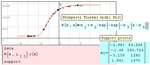

... Smath Thurber fit

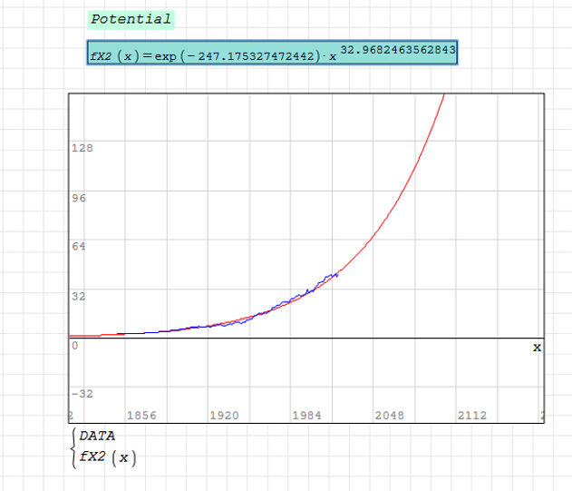

Hi Reg. The solution proposed at the post #4 in the file { CLIMATE CHANGE.sm (19,28 КиБ) скачан 1501 раз(а). } only uses an standard SMath plugin, for al_nleqsolve .
Click to enlarge
I assume that means I must write my own since nothing offered so far gives a good fit like the Mathcad exponential fit. ...
In this graph, the solutions of SMath, Maxima and Mathcad are compared. SMath's solution seems as valid to me as Mathcad's.
Click to enlarge
