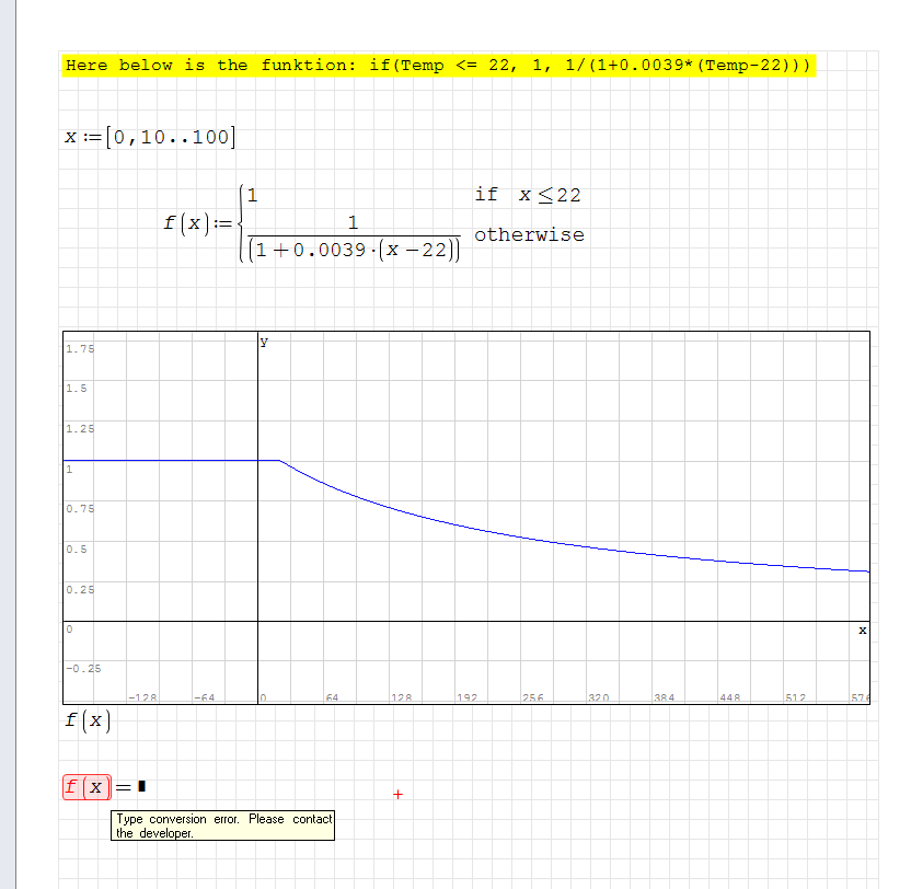

Hello everybody,
I use a beta-Version of SMath and have a question regarding the message:
"Type conversion error. Please contac the developer"
Problem_with_the_function.sm (4 КиБ) скачан 56 раз(а).
Best regards,
Andrey
Best regards,
Andrey

WroteI use a beta-Version of SMath and have a question regarding the message:
Assign value for evaluation.
Problem_with_the_function.sm (5 КиБ) скачан 54 раз(а).
