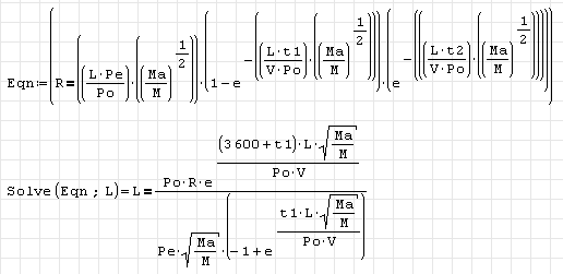

I am new to SMath. So far it's great I am impressed. I've been searching the forums for a solution to my situation. I haven't found anything yet.
Can someone educate me on this?
Any help would be greatly appreciated.
Here's a screenshot:
I know R from our mass spec measurements. I need to go back and find L (the actual leak rate of the device). There is no way to solve for L directly.
The answer for R=3.4*10^-9, L=5.612*10^-8... this is from a lot of work on my TI-85... I'm not 100% sure it's right...

Thanks, I'm not sure this solves my problem. This looks like it rearranged the equation, but did not solve for L.
#5 Опубликовано: 18.01.2014 04:22:04
You are right, I did not really inspect the result, sorry for that. Here is another proposal.
#6 Опубликовано: 18.01.2014 04:22:15
Martin suggests that you try to find L symbolically. Maxima returns L=f(L) which means that the function is nonlinear. Then you will go for a numerical solution. Numerical equations could be tricky. The best is first to try to plot it - to see the possible guess values and to see if there might be more solutions. See the pictures with the Maxima's L=f(L) rearanged equation and with your original (try to avoid so many braces - it is not needed). The second picture is with your original equation. This one is much more problematic for numerical solving. It seems that you need quite good guess value to get the second solution or you are going to get some value around zero, which is another solution (see the pictures). If you try to rearrange the eqaution is some other way, you might get no solution at all.
I do not know if this solution even have sense to you. There is another problem.

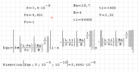

#7 Опубликовано: 18.01.2014 07:46:10
The equation has two solutions. Plotting the function f(L) is not very easy in the built-in plot region. Here is an example for how this can be done using the Maxima-Plugin. Not user-friendly either, but full control provided.

This awesome. I know for certain that the solution for L when R= 3.4x10^-9, is 5.614x10^-8.
So it appears there are many ways to get there. This is the first time I've used the program and I'm excited about all the possibilities. I'm going to try them all just to learn some more.

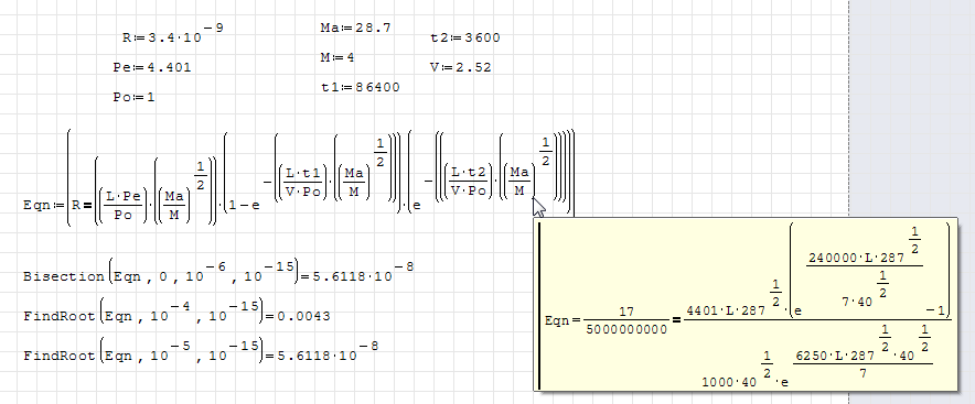

#13 Опубликовано: 18.01.2014 10:17:06
Here is the part of the Martin's file. Do you have problems here?
By the way, Bisection() and FindRoot() are not part of Maxima plugin. Moreover, I have no idea why do you have the "L-not defined" error here. Actually, L should not be defined here if you want to find the solution for L.

Sweet, adding the nonlinearSolvers plugin got me past the Bisection() and FindRoot() part. At this point I think I have my answer, but the plot is cool and I am going to have to figure that part out. For some reason I'm getting the "failed to load" problem still...

L not defined: I can just guess. If it happens with Solve, then possibly you use numeric optimization when displaying results. In the context menu (right mouse button) of the math region, you find an item "Optimization". This is ususlly set to "numeric", meaning that SMath Studio tries to display numeric values and eventually units of measurement.
Solve() returns the result as boolean equations "variable = value". This requires setting optimization to "symbolic" or "none" for proper display.
As to the load problem: It is essential that you use Maxima 5.31.1-1 instead of 5.31.2. I have no idea why, but that is the solution.

I downloaded the portable distro, thanks. I also found the 5.31.1-1 version of Maxima and that fixed my problems. The portable version works great as well.
