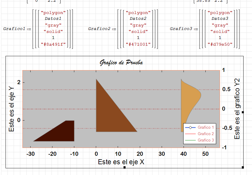

It's possible with XY Plot plugin
FilledArea.sm (15,59 КиБ) скачан 1664 раз(а).

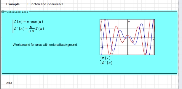

#4 Опубликовано: 28.06.2022 16:33:08
Hi. Agree, it could be a very nice feature. Just like books with different background color for text, samples, problems and case studies.
ColorizedArea.sm (5,46 КиБ) скачан 1657 раз(а).
