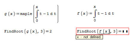

SMath solvers can't take an integral in the arguments, except al_nleqsolve.

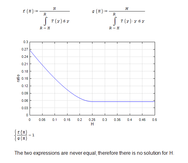

There are no roots!
mod: image link fixed; please use the forum attachment function (paperclip icon ) instead of external services
Worksheet4b.sm (18,29 КиБ) скачан 1290 раз(а).
