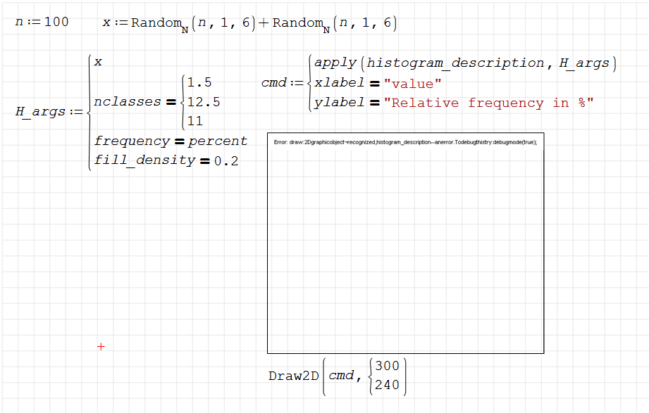

histogram_description error
It worked fine last time.
but today it doesn't work.
What's the problem?

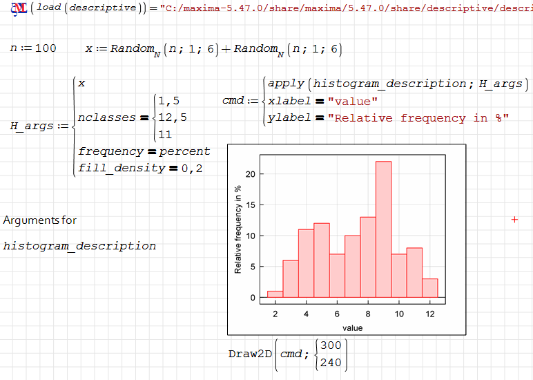

This function is part of the Maxima package “descriptive”. It must be loaded before using the command, just as with boxplot_description, where this is mentioned in the handbook. For histogram_description I forgot to mention this.
