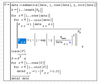

Thank you, for your recommendations. I updated my worksheet, but the "Requested matrix does not exist". I added a snip of the "P" matrix expected from the MC sheet. The updated SMATH worksheet is attached.
I printed the MC worksheet to pdf but it expands the page width, thus there are multiple cut-off pages.
Again, I welcome your review recommendation(s).

Alvaro 29.12.2022 15:09:00
I didn't revise all your functions.
Only P, but it results same as in mathcad.
Rest is up to you.

Hi. Happy new year and thanks for the pdf. Here some full vectorized versions.

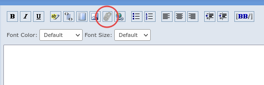

By the way, how do you post your screen snips in the Forum?
Thank you,
Norm
Thank you,
Norm
WroteBy the way, how do you post your screen snips in the Forum?
Use attachment button, and select a picture file.
In your case, a screenshot file.
