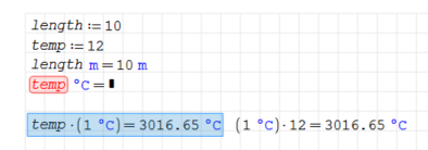

An image to describe the problem:

#2 Опубликовано: 17.09.2021 12:10:44
Ruben Sidranski
Ruben Sidranski
I can confirm. In addition, parenthesis and isolating the unit causes an error
Oscar Campo 17.09.2021 12:25:00, sergio 17.09.2021 12:36:00

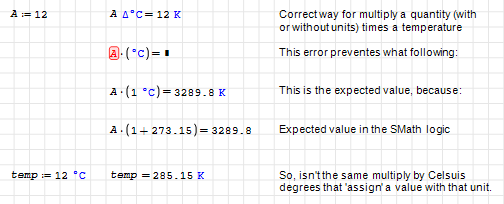

This image shows why I think that:
Oscar Campo 17.09.2021 15:56:00, sergio 17.09.2021 16:15:00
#4 Опубликовано: 17.09.2021 17:30:10
Arie
Arie
93 сообщений из 285 понравились пользователям.
I agree with Alvaro. The result is actually correct. I do believe it's still a bug, however, as you can add/subtract degC with seemingly strange, but correct, results.
