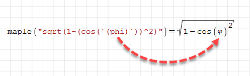

is this solution correct?
is this solution correct? - Сообщения
question_230609.sm (3,75 КиБ) скачан 1190 раз(а).
Obviously not, but the bug isn't that obvious: just avoid to use that 'phi' (j Ctrl-G):
churichuro 09.06.2023 15:32:00

Is this solution correct ?
As given, your function is plain/native. Nothing else applies.
Cheers ... Jean.
#4 Опубликовано: 09.06.2023 08:52:23
Is it only valid for Windows?
Linux mono doesn't have this problem.
#5 Опубликовано: 09.06.2023 09:07:42
1 554 сообщений из 1 864 понравились пользователям.
Yes, these are different letters:
cos(ϕ) and cos(φ)
maple() works with φ
This was done to unambiguously convert variables into Greek letters:
maple() function uses implicit encoding of Greek letters:

I think the result soomoon expects is this, but it requires a newer version of maple:
where can i get a new version of maple ?
#8 Опубликовано: 12.06.2023 11:12:20
Inside SMath, you can't. This is a workaround, valid for real values
#9 Опубликовано: 12.06.2023 11:29:29
Just in case that Maxima is an option. Unfortunately, Maxima requires the user to try specialized simplification functions and doesn't provide a powerful generic simplify.
trigsim.sm (2,43 КиБ) скачан 1157 раз(а).
