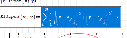

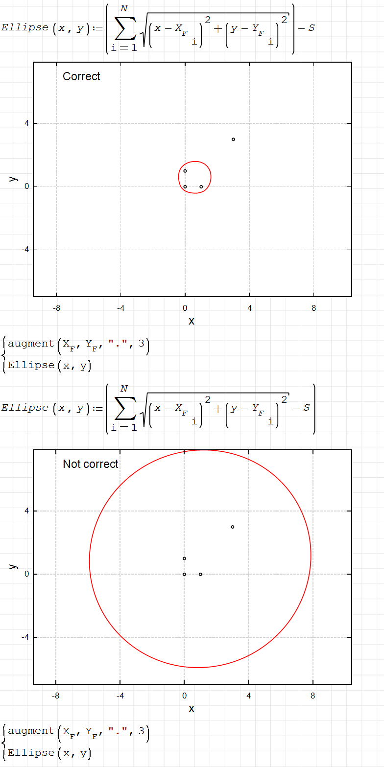

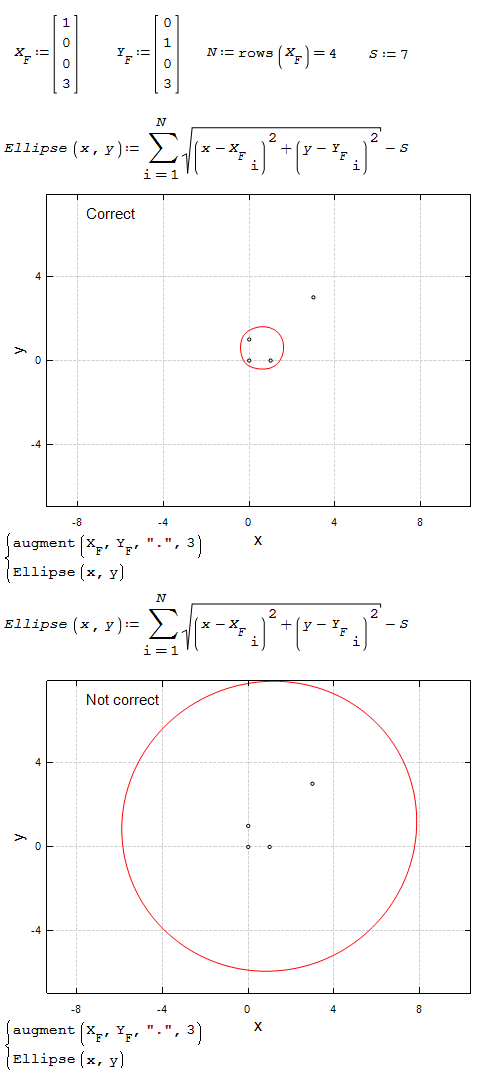

My students were building a multifocal ellipse and... almost went crazy. My ellipse is correct, but the student's is incorrect. Although the formulas are the same.
Can you guess where the error is and whether it is necessary to modify SMath so that such an error is visible?

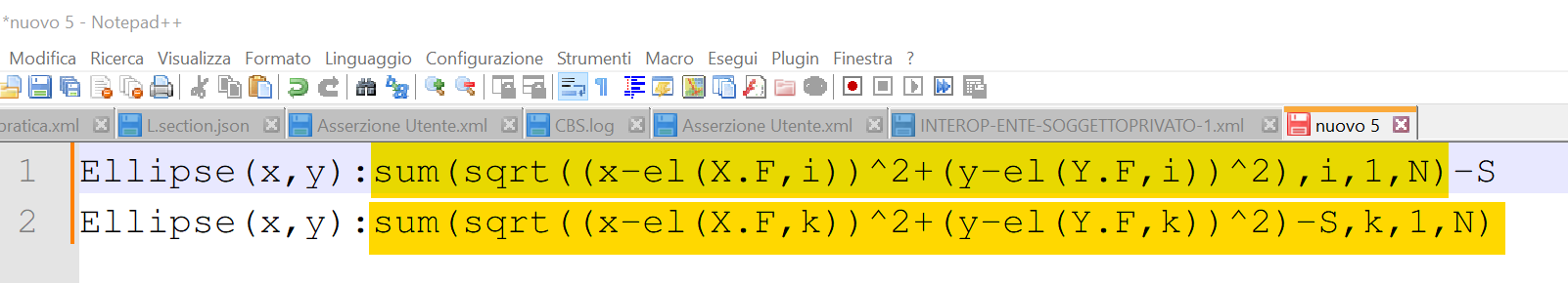

In fact only apparently the written formula is the same but in the first case "S" is outside the summation while in the second case it is inside the summation. You can verify this by copying and pasting the two formulas into a text editor.

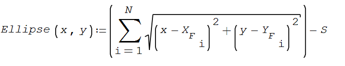

#3 Опубликовано: 07.09.2023 11:58:54
Arie
Arie
Further illustrated by adding parenthesis around the summation in each formula
Показать спойлер
#4 Опубликовано: 07.09.2023 12:00:34
Показать спойлер

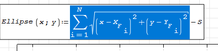

You can also select/double-click the sum symbol to check what belongs to it.
sergio 07.09.2023 12:26:00, Valery Ochkov 07.09.2023 13:42:00
#5 Опубликовано: 07.09.2023 12:01:59
Oscar Campo
Oscar Campo
The problem is that in the first Ellipse(x,y) definition, variable S is outside Sum function, but in the definition of your students is inside:
Your definition:
Ellipse(x,y):sum(sqrt((x-el(X.F,i))^2+(y-el(Y.F,i))^2),i,1,N)-S
Student´s definition:
Ellipse(x,y):sum(sqrt((x-el(X.F,i))^2+(y-el(Y.F,i))^2)-S,i,1,N)
Maybe, this explicit form is most clear for students:

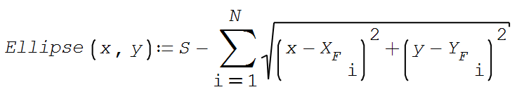

#6 Опубликовано: 07.09.2023 13:43:13
Valery Ochkov
Valery Ochkov
Better so

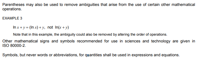

#7 Опубликовано: 07.09.2023 14:24:15
Better so ...
You can tell your students that you are using the Note under Example 3 of point 7.1.3 of ISO 80000-1:2009(E) Quantities and units, Part 1: General.

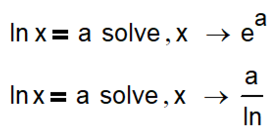

#8 Опубликовано: 07.09.2023 15:28:30
Valery Ochkov
Valery Ochkov
It if Mathcad 15
1 ln(x)
2 ln*x - why not
