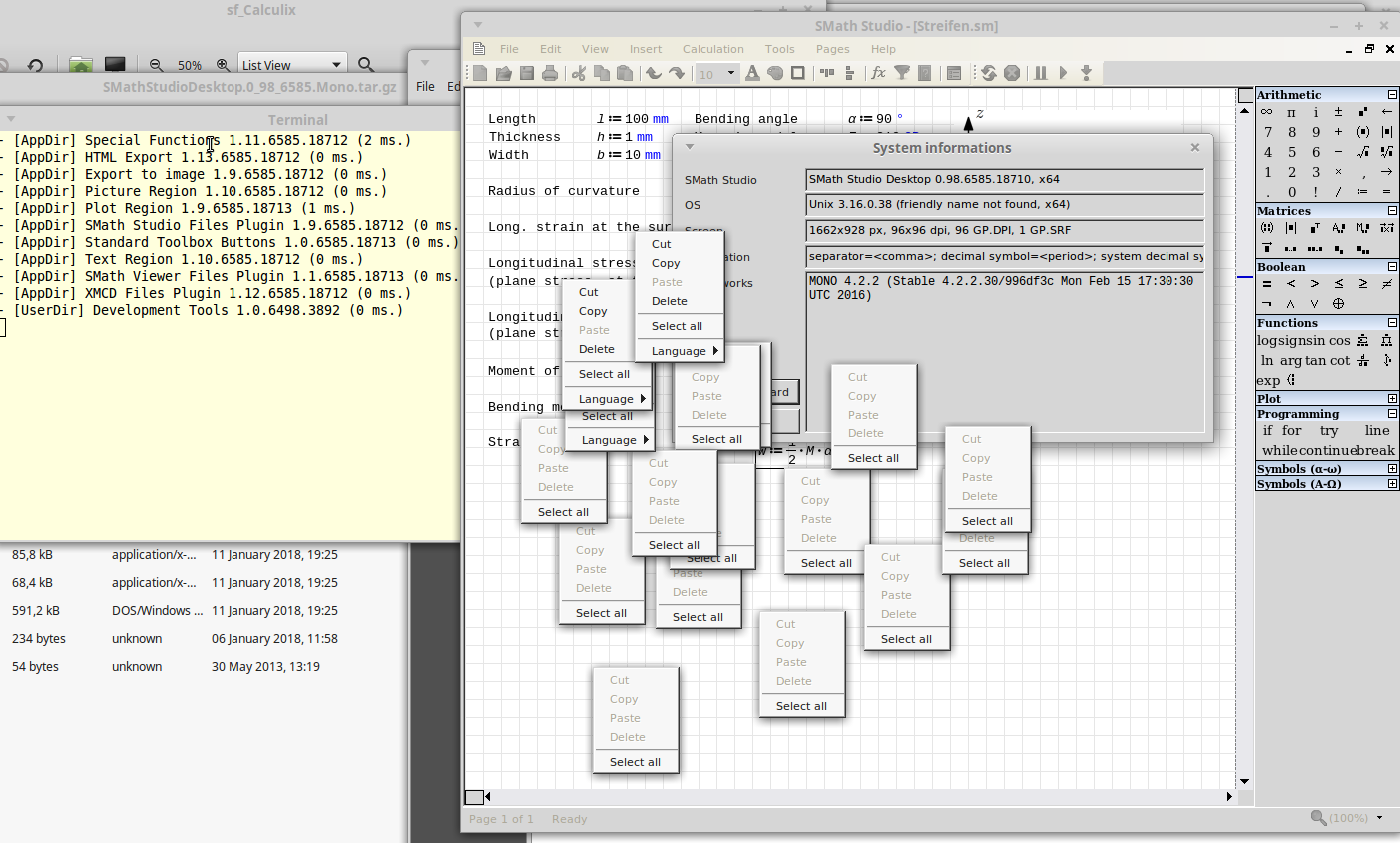

SMath Studio: SMath Studio Desktop 0.98.6585.18710, x64
OS: Unix 3.16.0.38 (friendly name not found, x64)
Screen: 1662x928 px, 96x96 dpi, 96 GP.DPI, 1 GP.SRF
Localization: separator=; decimal symbol=; system decimal symbol=; language=ENG
Frameworks: MONO 4.2.2 (Stable 4.2.2.30/996df3c Mon Feb 15 17:30:30 UTC 2016)
Mint 17.2 on a Virtual box.
I get a strange error: The context menu doesn't close and stick in the foreground. This is triggered by trying to zoom the canvas by ctrl-drag middle mouse button (Lenovo thinkpad trackpoint). The menu windows don't vanish when the program is closed. They only vanish if the temporary terminal window is closed as well.
There is no way to zoom the canvas with trackpoint or trackpad. I have to use the status bar zoom menu for zooming.
Under Windows I can use two-finger guestures on the trackpad to zoom.
This may be due to insufficient hardware support in the linux box.
BTW 6580 crashed when I started typing to the canvas. This problem is solved now even though my mono might not be up to date.
2018-01-11 23_59_09-Mint_Mate_Mech_2015_10_30 [wird ausgefuhrt] - Oracle VM VirtualBox.png
Andrey Ivashov 12.01.2018 00:46:00

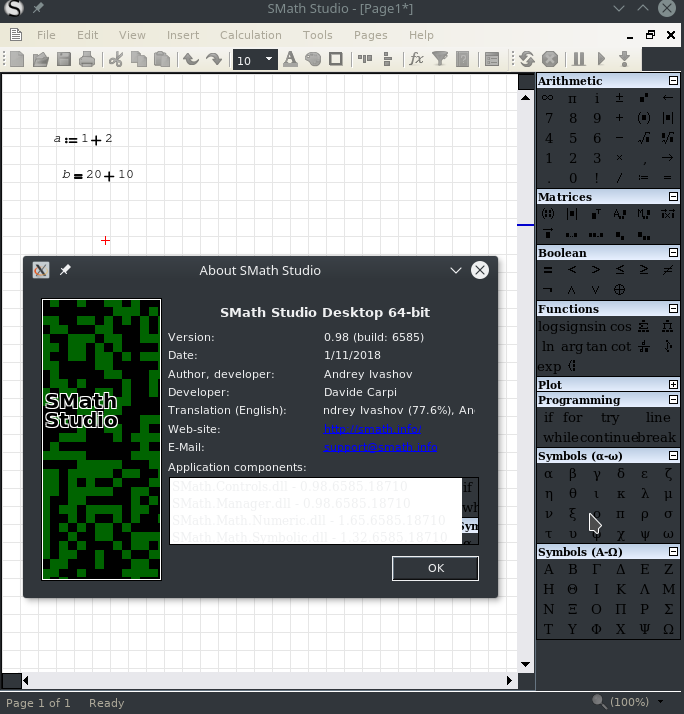

#9 Опубликовано: 12.01.2018 20:38:18
David Avila Cortes
David Avila Cortes
1 сообщений из 2 понравились пользователям.
Ubuntu 17.10 Gnome 3.26.2 64-bit
Mono JIT compiler version 5.4.1.6 (tarball Wed Nov 8 20:37:08 UTC 2017)
it works well overall, a few graphical bugs like white patches on the notebook background that disappear when dragging a selection box over them, the big bug that persist is the Data exchange plug-in, I just cant get it to work properly when I try to save my files as a XELATEX document, it will either crash immediately, display improperly the options box or simply display errors on the console.
Only when keeping the smath app window unmaximized and with all other windows minimized have I been able to save the file properly it doesn't always work though
Andrey Ivashov 13.01.2018 10:41:00

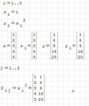

#16 Опубликовано: 17.01.2018 05:49:39
Really nice!
Andrey Ivashov 17.01.2018 13:23:00
