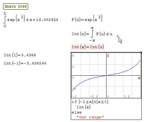

Try integrate GID style [GID => Get It Done]. Works well.
Quite a long epansion ! Does not plot otherwise than GID.
Scrap Integrate GID.sm (17,33 КиБ) скачан 1167 раз(а).
Read more in the attached. Your Int[exp(x^3)] is DEFINITIVELY wrong
and DEFINITLY wrong ... Why ? Plot first ... so what ?
So what: the inetegrator is kitchen style, totally incapable of
integrating in the infinite limit. As it looks in the range 0..2
the result is X^huge ...X^zillions. Alternately it might be possible
to use Legendre method. There may be an example in Samples. Still you will
have to compose Legendre coefficients from the web. From recollection they
are tabulated up to 50. A quick way is to tabulate exp(x^3) and use the
FD [Finite Differences] integrator.
The maple GAMMA may not have the Smath equivalent ... another puzzle .
Cheers, Jean

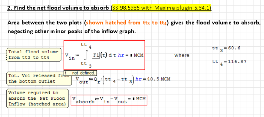

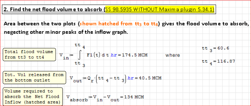

Two images WITH and WITHOUT Maxima plugin 5.34.1 attached.
SS file also attached
Reservoir Flood Capacity Estimation-R1.sm (189,41 КиБ) скачан 1173 раз(а).

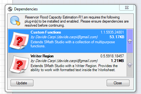

ndtma,
You have other plugins that may not be playing nice ...
I had to update "Custom Functions" and download "Writer Region"
Also, in lieu of the SS version ..., use the new built in "appversion(3)=" function
Looking at your sheet as I write this, but wanted to point out the other plugins.
Confirmed Maxima crash ...

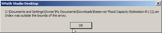

The two plugins were already updated.
Before writing to the forum, I tried a clean re-installation of SS 98.5935 with minimum required plugins installed and updated.
But still the problem with Maxima plugin remains.

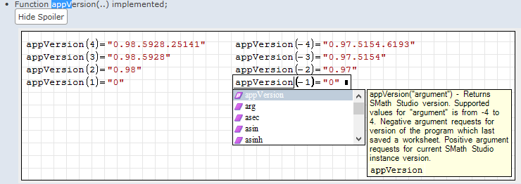

By the way how do you use "appversion"?
Look within!... The secret is inside you.
Eng. NDTM Amarasekera - Sri Lanka
Elsid.
Thank you
Thank you
