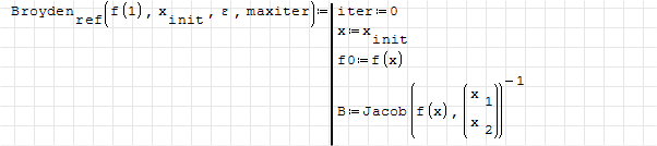

The function as in the *.sm file doesn't work because the first approximated inverse jacobian ( B ) is an Identity matrix... i've seen that is a common issue (f.e. root finding methods)... in SMath this could be fixed using the Jacob() function on the user input solution (see the attachment).
Unfortunately the function Jacob() (as well as other functions such as error() function) are not in the 4 standard libraries; I will try to see if importing the library on which it was made by Andrey can be implemented.

i've implemented this script in a Smath sheet and it's more readable, unfortunately the issue related to the first Jacob approximation still remains

Wrotewow, have you used bisection as an initialization of broyden ?
also i've searched information about the broyden method over time and it seems the most advanced/recent version is a modification of Johnson's by Baran :
http://arxiv.org/abs/0805.4446
As for the Jacob() function, I thought that Broyden didn't use Jacob directly but an approximation..

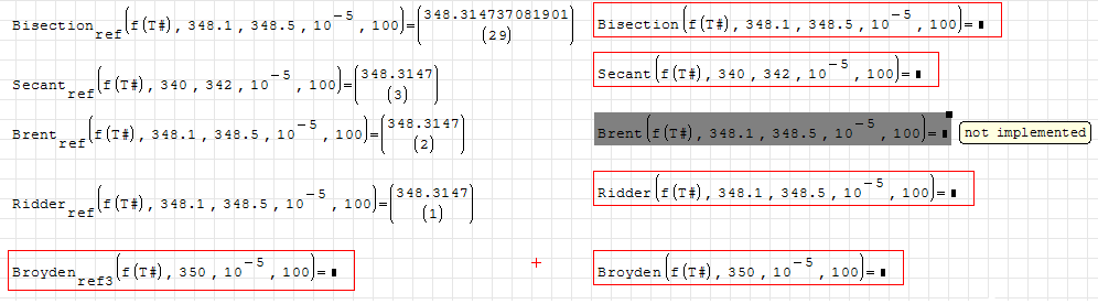

@w3b5urf3r Based on the picture in your previous post (many methods in a plugin), did I say that you are my hero?
