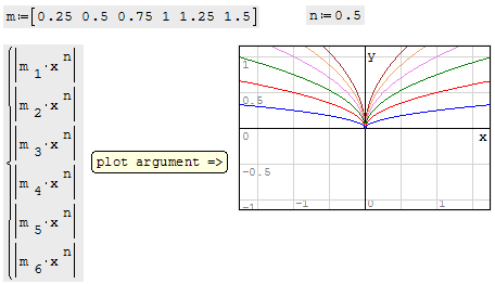

1 - How does one create a Figure like this example...
Figure 1
Must you create the graph in SMath and then copy the screen to a graphics program like Paint or Inkscape...
and then add the additional text, arrows, etc?
Or is there a way to do this all in Smath or another application?
... try n 0.5, 1, 3, 5

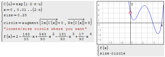

This is not a capability of SMath itself, yet. Obviously people need this feature.
Actually this was debated in "idea for future plugins" not long ago.
Idea was to draw simple shapes similar but not same as in inkscape or office programs.
You need to use third party programs or online pages and insert them later. https://editor.method.ac/
You can always draw additional line and arrow on graphic itself using functions with some effort.
But this will never be simple as you could pick an arrow shape from toolbar and inserting in to canvas.
