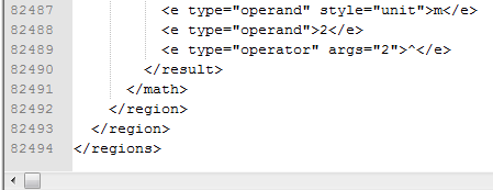

Hi all,
Trying to reopen a file that I wrote and that refused to be closed normaly, I receive this message:
I posted the file here:
file
Is it possible to recover the file ? If yes, how ?
"Unexpected end of file occured.
The following elements are not closed:
result, math, region, regions. Line 82490, position 12."

The solution is indicated by mkraska and the result is in the attached file

WrotePlease attach your file to the forum: http://en.smath.info/for...dex.aspx?faq=attachments
I agree, Ioan please attach the file directly to the forum or use a registration-free hosting service...
WroteThe problem might be solved by just closing the xml tags in the file
