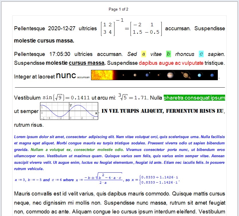

Document mode is a mode when one is working with a file like in MS Word. This is a text processor with possibility to insert equations. The only difference is that these equations are automatically calculated!
What to expect:
  • There is no red cursor anymore;
  • Enter can be used to make line breaks (no need to press Ctrl or Shift to make it work);
  • Everything is vertically aligned by a baseline.

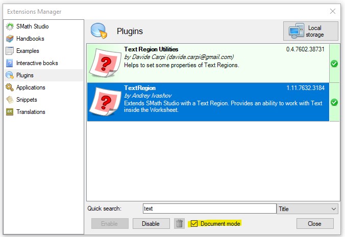

  1. Open Tools > Plugins..., find and select Text Region, set Document mode checkbox checked:
  2. Find a New document item in File menu:

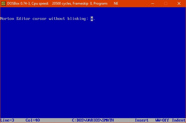

#6 Опубликовано: 25.11.2020 16:58:50
Great!. Just a note.
This is a very first version, so it has many obvious issues, like:
  • Text Cursor is not blinking;
Best regards, Andrey Ivashov.

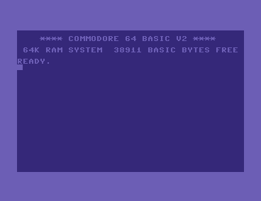

That's could be not an issue, but a feature. Just make it an square without blinking, like in Norton Editor! It's more peaceful write without a cursor continuously blinking in front of the user face.

#8 Опубликовано: 26.11.2020 08:32:56
You couldn't be any more right.
Nothing triggers me to write something more than a nonblinking cursor.
Probably I love retro more than I think.
Alvaro 26.11.2020 16:45:00

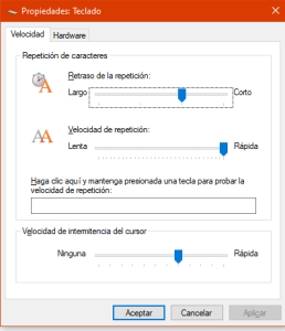

#9 Опубликовано: 26.11.2020 08:52:35

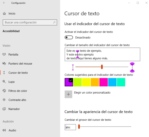

Blinking cursor makes easier for the brain to spot immediately the position (like when you have to spot the position of an animal in the wild). Solid cursor is nice but is a little bit odd with non monospaced fonts.
#10 Опубликовано: 26.11.2020 16:56:22
Ups. I'm not thinking about that. With proportional fonts it probably doesn't look as good, and a blinker free bar is harder to locate. Actually it's explained here, in french:
https://fr.wikipedia.org/wiki/Curseur_(interface)
#11 Опубликовано: 27.11.2020 11:19:22
If it matters I might introduce a setting in WriterRegion to choose if the caret blinking should be enabled or not, it doesn't cost too much effort since everything is already in place.
#12 Опубликовано: 27.11.2020 22:40:50
Hi Davide, thanks for the offert, but I guess that it isn't necessary, or maybe better take the defaults in the OS system, which in windows are stated according this two images.
For monospaced texts, like ones in the Viacheslav's Memo plugin, the option for having other cursors could be more interesting, and have some tools for change fore and background colors, like an nfo viewer, like this one:

  • So, now it is possible to perform formatting of text fragments in Text Region, not only the whole content as it was before.
  • Another interesting feature is auto detection of equations (and horizontal rules) in the text: write 2+3 or anything else and program will automatically convert it to Math Region inside a text).
Of course all the features (except paragraphs in text) supported in Document and Worksheet modes of SMath Studio.

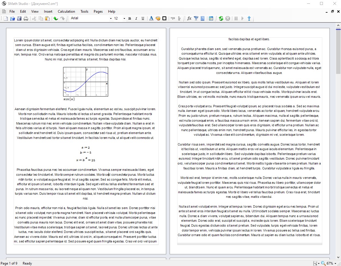

It includes the following improvements for Document mode:
  • Automatic replacement made more smart;
  • Support for text indentation and left padding implemented (use Tab/Shift+Tab for the start of new paragraph or text selection);
  • Buttons to work with text indentation added to the main toolbar (visible in Document mode);
  • Anchors is now fully supported (http/https urls and path to *.sm files) - can be set manually in the *.sm file using HTML-like A tag;
  • Empty paragraphs and line breaks is visible on text selection;
  • Result files size reduced;
  • Cursor rendering improved;
  • Up/Down keyboard commands handled accordingly now;
  • Work with Header/Footer restored.
The main change here is text indentation and better text-to-equation replacements. It is now possible to create formatted text documents... it is pretty easy and convenient.
