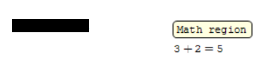

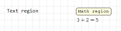

Text regions appear with a black background when the file is saved as an HTML page. SMath Version 0.99.7921.69
SMath screen capture
HTML output page screen capture

Thank you, bug confirmed and fix tested and committed to the repository.
from recollection: not attended ... still existing once in a while.
Worksheets with unwanted black background still exists because is a property saved in the affected files, but those are a marginal number and the bug on saving is fixed in recent versions of SMath Studio.
Since black is a valid background color there aren't robust ways to improve the loading of affected files directly on program side (and anything would add a small time penalty on loading for each region in each file, all for a once in a bluemoon case, very noticeable and easily fixable from user-side that single time it happens).
To fix those existing worksheets you can either:
1. open the file, select the black regions and change the background color to transparent;
2. use a batch fix method like those proposed here: https://en.smath.com/forum/yaf_postsm75355_Black-regions.aspx#post75355
