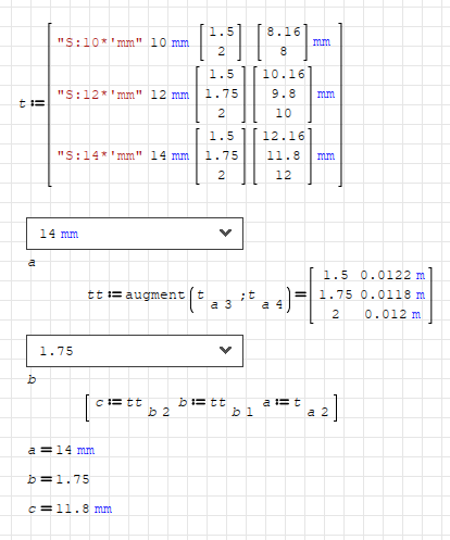

You may need a temp data derived from first combobox selection.
And use that new data at second combobox.
Here is your both questions answered.
combobox_question.sm (8,36 КиБ) скачан 775 раз(а).

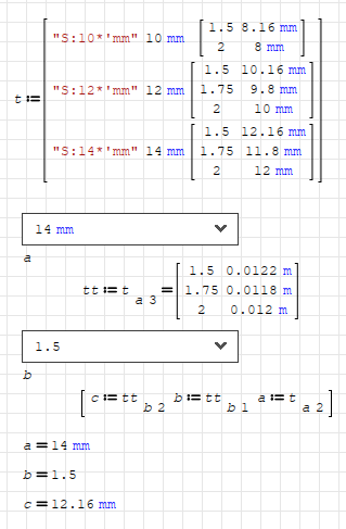

You can reduce data matrix like this too.
combobox_question.sm (8,29 КиБ) скачан 803 раз(а).
Exactly what is needed. Thank you!
