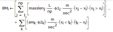

I am trying to convert a Mathcad 15 sheet, and have a problem with the below equation:
Is there a summation within Smath that will do the second summation?

Hi. There are not equivalent, but this is how to convert it into usual summation operator.

Hi. As Viacheslav says, it's better in this case the mathcad file. Just a couple of notes.
You use a for loop with i as counter. Thus, at the exit, i equals the last count value, not the entire range. So, or you redefine i as range, or use this way for not changing i value
Actually, SMath doesn't have "range" variables, it only have scalars and matrices. But mathcad have "true" range variables, which it's more a complication than an adventage. BTW in SMath you can't use a range variable in the same way, and sometimes needs some dummy variable for detect them
Finally, remember that in mathcad sqrt(-1) is 1i, but in SMath it is just i, so using is as counter you loose all the complex algebra.
I think that there should be such a replacement.
