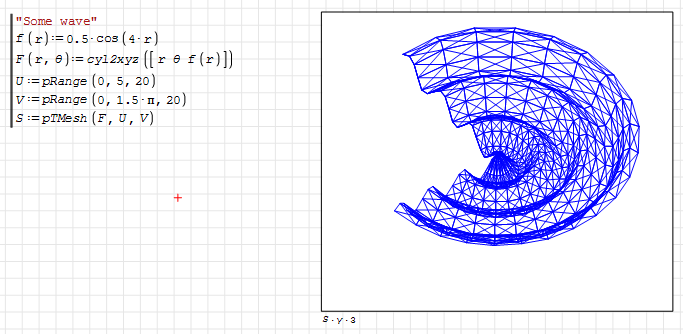

Hi. There are several variants for the triangular meshs. This is one.
pTriMesh.pdf (459,2 КиБ) скачан 831 раз(а).
pTriMesh.sm (29,35 КиБ) скачан 1474 раз(а).

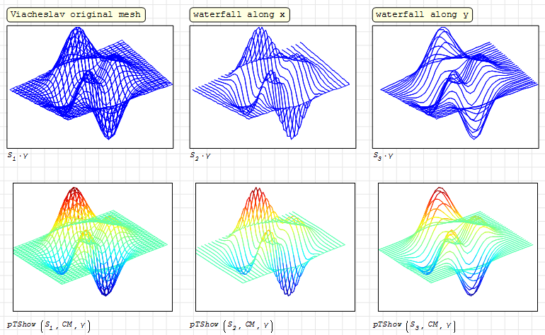

Hi. More general mesh utility, with a variable patern. Also, waterfall plots (matlab page here).
pWMesh.sm (193,8 КиБ) скачан 1455 раз(а).
pWMesh.pdf (3,2 МиБ) скачан 898 раз(а).
