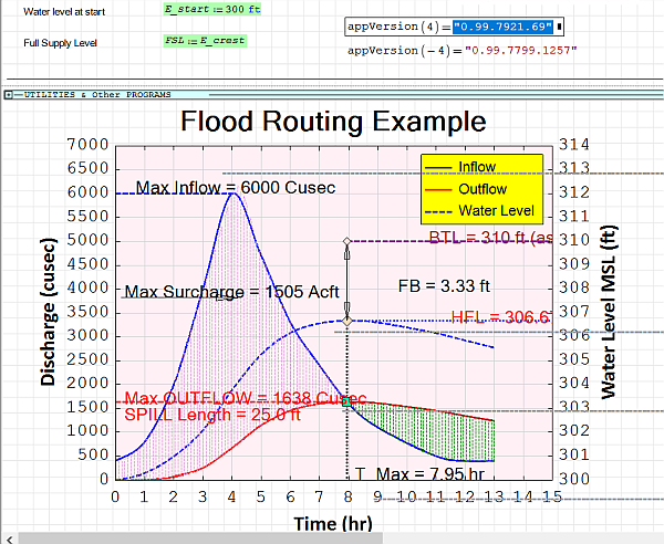

With the latest SS 0.99.7921.69, the XYPlot fonts appear enlarged compared to previous versions.
No problems with ZedGraph.
Flood_Routing_Test.sm (1 МиБ) скачан 65 раз(а).

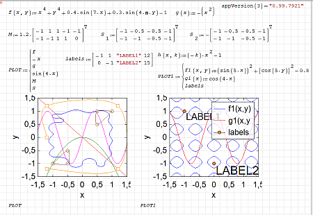

Another example where XYPlot fonts enlarged.
#3 Опубликовано: 11.09.2021 19:44:15
1402 сообщений из 1708 понравились пользователям.
It looks like it has something to do with the monitor's high resolution. There is no such effect on my current monitor. If this is the case, then I can't make the fix now. I need access to a higher resolution monitor for testing.
