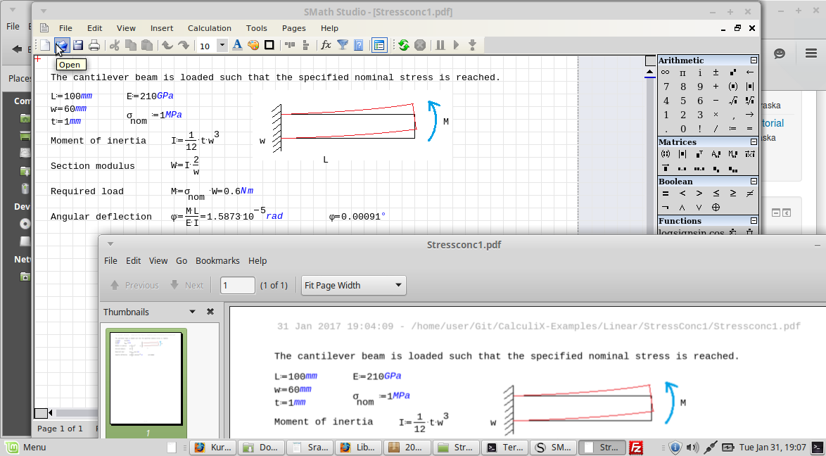

Did you try File> Save as> File format: PDF?
This works for me in a virtual linux box under Win 7
You need the pdf files plugin.
If you use the portable distribution (link in signature), many plugins are pre-installed (the maxima plugin, however, does not work under linux)

#4 Опубликовано: 31.01.2017 16:15:31
Martin many thanks,
but printing via Windows weather in a real or in a virtual machine is not a problem for me. This works flawlessly. Also with a "real" printer.
My question targeted the Linux version mit mono. And within this version it is not possible to save the file as a *.pdf.
And also printing to a real printer does not work for me.
Greetings from Austria
Leopold
Actually, the VM runs ubuntu and SMath is executed with mono in the screenshot. The displayed pdf is generated by save as under linux. As I said, you need to install the pdffiles plugin by Andrey Ivashov.
I believe that this is not affected by whether linux is run on a virtual or physical machine.
BTW, this is also advisable unter windows, as it avoids the usual font size problems when printing directly (depending on dpi settings the region scaling is a bit unreliable.
