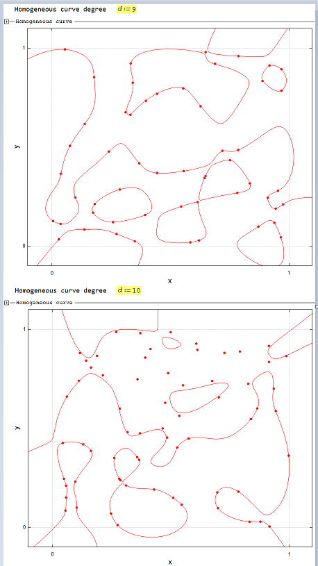

General case.
Homogeneous Curve.sm (27,07 КиБ) скачан 1423 раз(а).

Yes, that's the sequence. It is the number of coefficients that have a homogenous bilinear form in two variables. And is the number of rows in the matrix 'v' in the file.
Limit at n=10
I put the comments backwards. For big n, disable the SMath matrix inverse method and use dn_LinAlgSolve.
Homogeneous Curve.sm (31,07 КиБ) скачан 1353 раз(а).
I suppose it can be easily generalized to three dimensions, except for the part of graphing the surface, since there we would not have the usefulness of XYPlot to graph implicit functions.

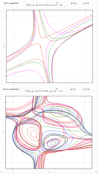

#9 Опубликовано: 01.11.2023 02:54:32
With n level curves, one passes through each X,Y pair at level Z. For d=1, we have a plane, d=2 a quadric, etc.
Homogeneous Surface.sm (33,63 КиБ) скачан 1422 раз(а).
