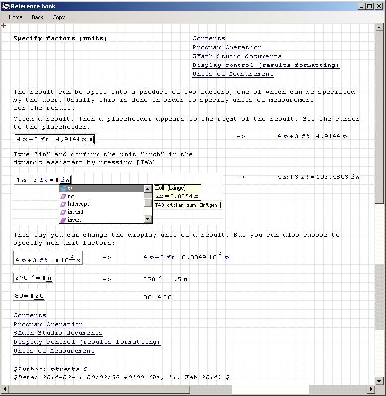

You must use absolute temperature scales for differences of temperatures or temperature changes (as in ratios of some change versus a temperature change like coefficient of thermal expansion). See the attached handbook pages and feel free to translate them to spanish ;-)
