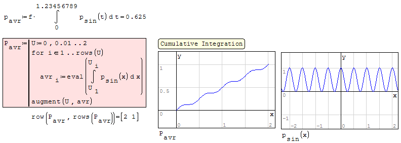

#3 Опубликовано: 20.04.2019 15:04:11
I was writing an example and meet a possible issue.
Like this ...
ISERROR QUESTION MARK.sm (16 КиБ) скачан 74 раз(а).

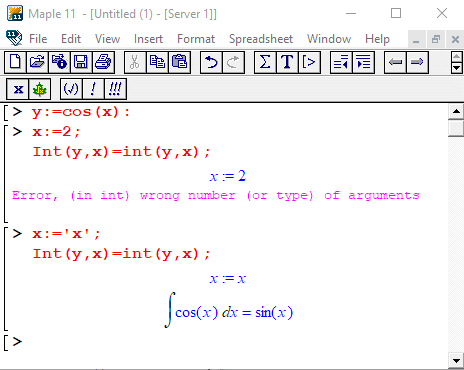

Hi. It isn't in other software, like maple. Usually it must to be an undefined name:
frapuano 23.04.2019 15:20:00
#6 Опубликовано: 23.04.2019 16:09:05
Still, I found that the integration variable is not quite independent (local) to the integral function.
Yes, like in Mathcad, in the wild domain of integration
Doctored in red, attached ... Cheers ... Jean
ISERROR QUESTION MARK_2.sm (18 КиБ) скачан 65 раз(а).
