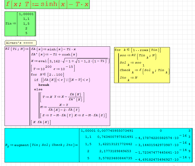

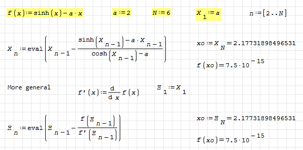

Hi ioan. If we understand 'analytical expression' as 'closed form', the answer is that there is none. But if the objective is to find the real solution, with as many digits as the precision of the calculator used, then it is enough to remember that real numbers are introduced to be able to calculate limits, so this would be a valid answer.

Hi Alvaro,
Thank you very much for your answer.
1. In fact, I’ve already used the Newton solution. I like your elegant iteration control. I used a trivial "for" or "while" command. However, the result’s precision is essentially dependent on the machine’s precision (bytes number on a variable).

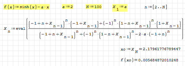

Hi ioan.
Here the root is expressed as the limit of a recurrent sequence as well, but in terms of basic operations.

ioan92 30.09.2023 15:13:00
Hi Alvaro,
Thank you very much for your additional solution.
This last solution seems resulting with a more modest convergence.

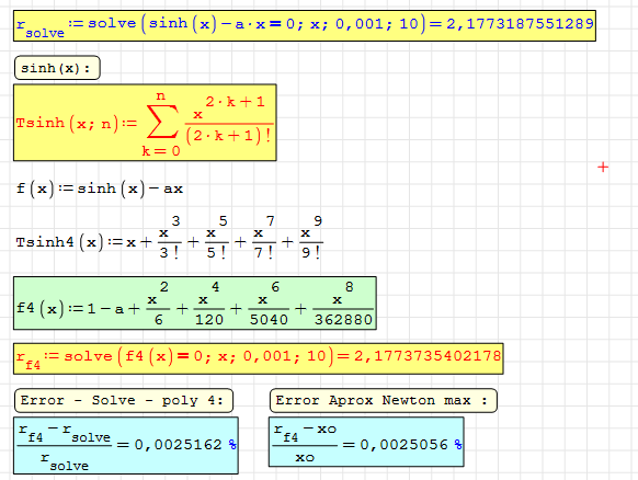

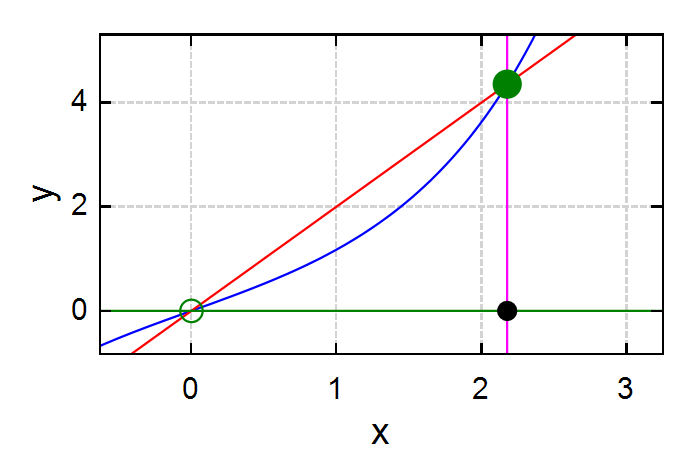

The graphical image of the case is:
It seems that the 4th degree polynom decomposition of the equation, solved without any iteration is enough reasonable; of course, less compact than the solution based on the solve function

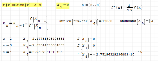

Wrote... This last solution seems resulting with a more modest convergence ...
Yes, it is. But it uses only algebraic operations! This other provide a better approximation using actually only one expression, even it is very long (19060 for the string length)

I enjoyed very much your elegant and compact solution based on the Newton method.
Comparing your Newton type solution with one of mine, I noted some differences, namely:

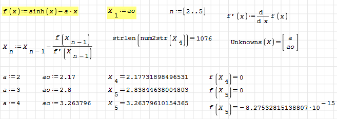

Hi ioan. Dichotomy is always better because it provides an interval of the solution. Here, some other notes:
You're right: the start value is part of the solution, and it requires better attention. This version uses different guess values.

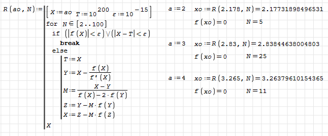

This other is an Improved Ostrowskiroot-finding method, by Miquel Grau & Jose Luis Diaz-Barrero
nr-example 3.sm (19,28 КиБ) скачан 1358 раз(а).

Finally, I mixed my raw first approximation with your last findings and here it is:
![2023-10-02[SelectPlus.sm_].png](/ru-RU/files/Download/B4r2dP/2023-10-02[SelectPlus.sm_].png)
