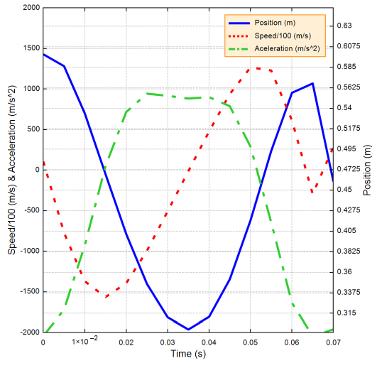

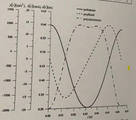

Is it possible to make such a chart with three Y axes on a single chart?
something like this
https://ibb.co/JcRn2B9
You can have as many as you want of fake style like the image.
Create Y's as image and slide close to the plot.
You can do lot more Professional ... associate each graph with Nodes Labels.
Cheers ... Jean.

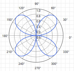

Using X-Y Plot Region, you can simulate your graph with any number of axes, but needs some programming like in this example.
XYPlot. Linear polar.sm (61,18 КиБ) скачан 1175 раз(а).

It is possible to use a graph with 2 Y-axes as shown in the image.
Carlos
#9 Опубликовано: 08.05.2022 17:37:38
... as many as you want horizontal/vertical,
disposed inner wrt the Quick Plot
otherwise outside X_Y past build-in default 2.
Utilities XY Label Graph MORE.sm (35,86 КиБ) скачан 1207 раз(а).

Hello
I think your graph could be like this
Three_exes_Graf.sm (32,97 КиБ) скачан 1190 раз(а).
Carlos
