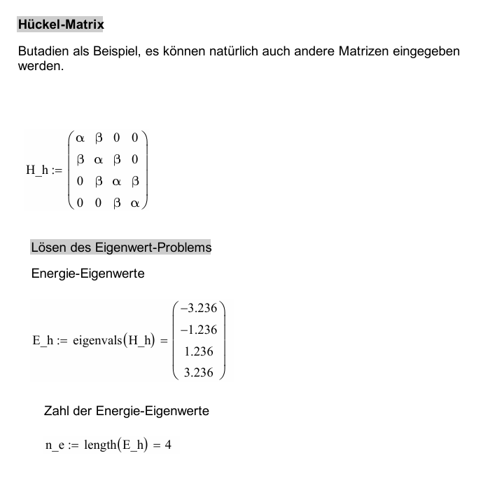

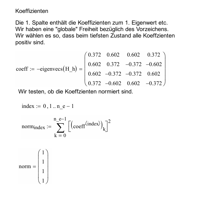

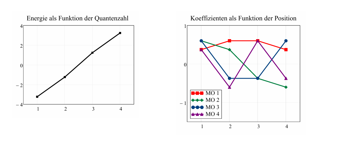

Dear all,
I'm trying to convert a Mathcad file into SMath but encountered some problems.
First, there is no direct function for eigenvalues. I tried something from another post. Unfortunately, the last two digits are swapped. I don't know where I went wrong.
Does anyone have an idea how I should proceed with converting the additional document?
The files are attached. If there are any difficulties with my German files, I am happy to help.
Thank you in advance!
Caro
hueckel_matrix.sm (11,17 КиБ) скачан 212 раз(а).

Thank you for your help!
I replicated everything you did, but somehow norm= can't be defined. My Smath automatically fills in norm:=
I don't understand where I went wrong, since I did everything exactly the same way.
