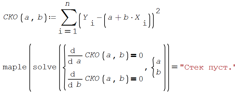

How to solve this symbolical
How to solve this symbolical - Maple in SMath - Сообщения
#1 Опубликовано: 08.07.2023 12:36:53
Valery Ochkov
Valery Ochkov
3-5.sm (3,97 КиБ) скачан 1271 раз(а).

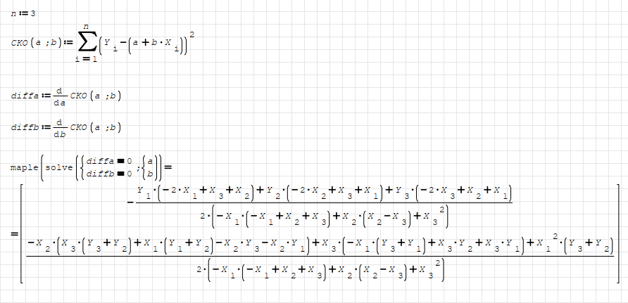

Derivatives mostly doesn't get along with solvers.
And you really need an n value to make this work.

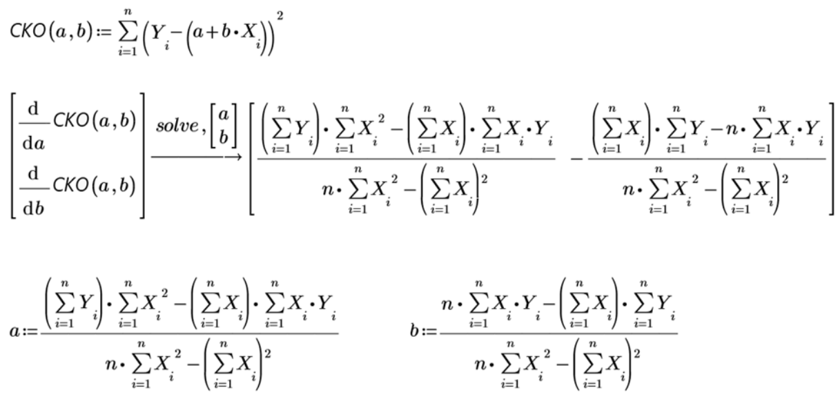

Thanks.
But I was waiting as in Mathcad

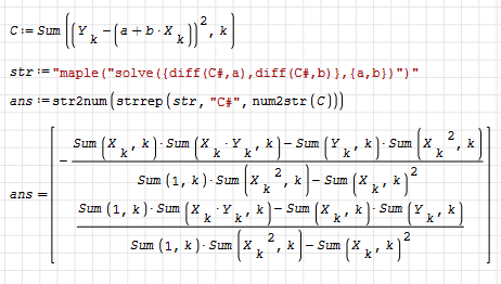

Hi. This is a way.
linregress.sm (17,05 КиБ) скачан 1274 раз(а).
linregress.pdf (85,29 КиБ) скачан 990 раз(а).

1 C:=Sum...
2 ans:=...
#6 Опубликовано: 09.07.2023 04:47:30
Thanks!
But what is it?
1 C:=Sum...
2 ans:=...
It's a maple component from the maple tools plugin. You must to have it at the insert menu:
#7 Опубликовано: 09.07.2023 23:18:19
This is a way that avoids using the component and uses the maple function
