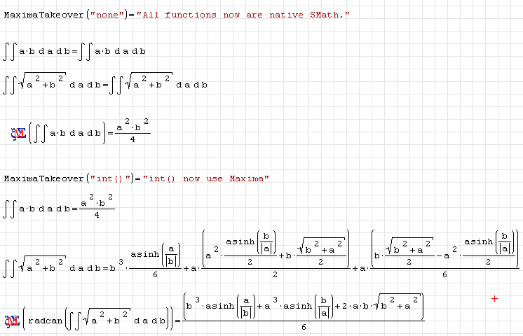

This is what Maxima does.
Edit: the second integral can be simplified using one of the many Maxima simplification functions.
