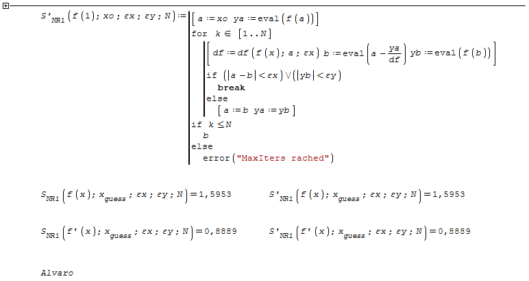

Hi. I can't call a function which uses a call for functions too. How to solve that? Example in the attached.
function_1v.sm (17,56 КиБ) скачан 1284 раз(а).
#2 Опубликовано: 02.04.2019 10:09:35
I guess f(a) isn't recognized as a function in the call df(f(a)...) as f(a) evaluates to a number, not a function. Use df(f(x)... instead, with x being something undefined.
Alvaro 02.04.2019 10:14:00
#3 Опубликовано: 02.04.2019 10:13:54
Hi Martin. You're right! Thanks.
