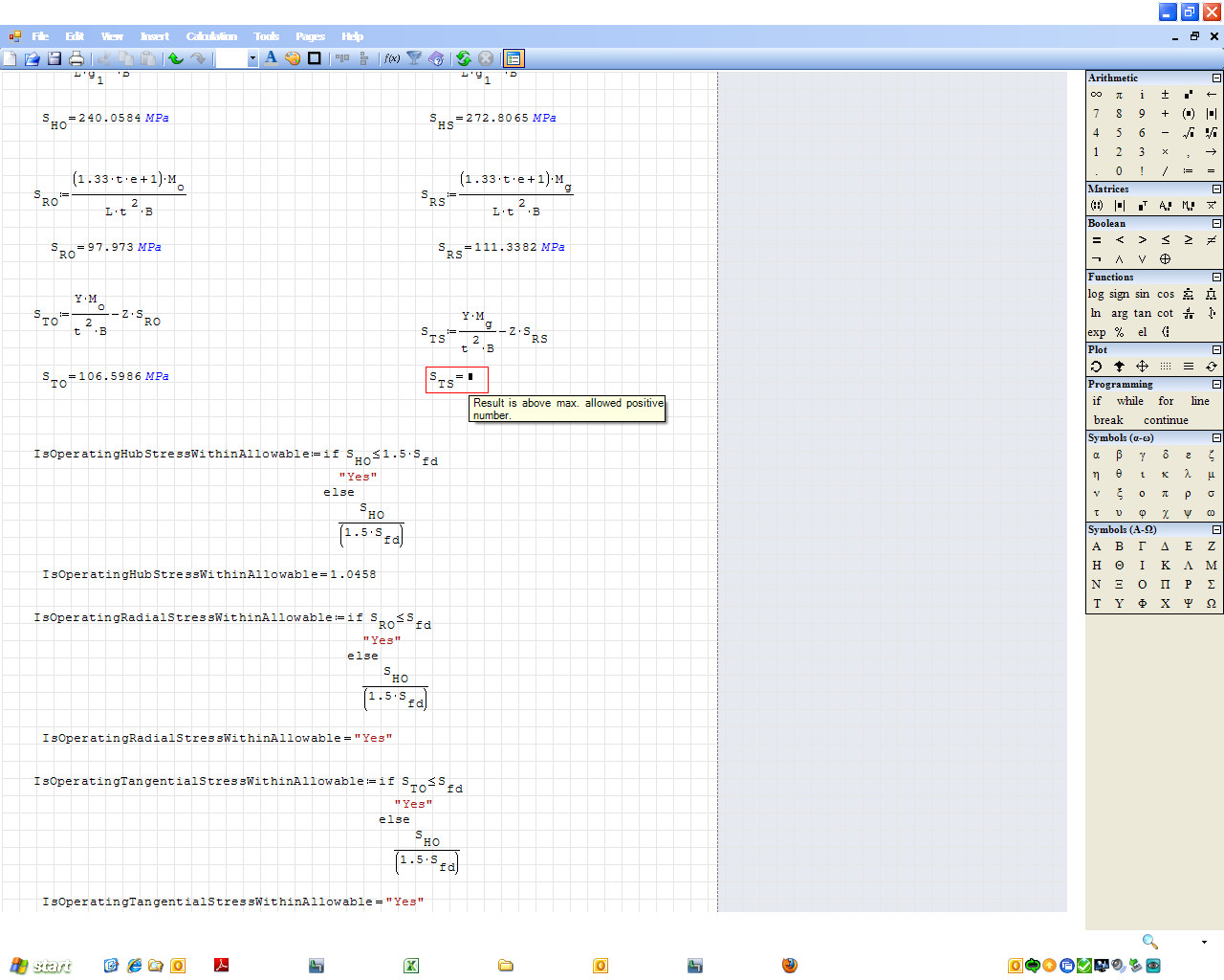

Error: Result is above max allowed positive number - datsnl - Сообщения

Before you send it to me, you could just try right click on the regions and choose Optimize|Numeric, or enclose the calculation in eval() - right hand side of the assignment ( := ). This will work most of the time if you just work strictly with the numerical values.

Hi Omorr,
When I right clicked on the region and selected Optimize, it was already selected to Numeric, so I didn't change anything there.
But your eval() worked like a charm.

EDIT: Unfortunately, I can not explain and I do not know why and when is this happening. This is some internal SMath problem and there is no other way except to use it in these kind of problems.
