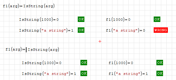

I found this bug defining user functions with IsString()
The issue disappear using IsString inside line()
regards,
w3b5urf3r
regards,
w3b5urf3r
I'm not sure whether this is a bug or a delayed-evaluation 'feature' of using/not-using the program line. I raised a similar question about a month ago ...
How is the equality (ctl-=) operator supposed to work? I get ([1]=1)=1 but ([1])=2; the latter I expect, but I am surprised that a matrix is equal to a scalar, even though it is just a single element matrix.

#3 Опубликовано: 29.07.2012 14:55:10
Thank you! Fixed.
Regards.
