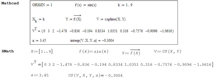

CS only do what mathcad's cspline do:
#7 Опубликовано: 29.08.2018 16:16:49
Hi Jean. There are not to much shadow in that small code. It's just the implementation of the traditional spline interpolation. In SMath there are not, or I can't found, the function cspline. The interpolation with cinterp in SMath evaluates the vector V each time that you call it, it's always better to have V=cspline(X,Y) and then call interp(V,X,Y,x). Finally, I want to implement an adaptive step size for the intervals in X. But first I see very convenient to have vectorization and plotting issues solved.
CS only does what Mathcad's cspline does:

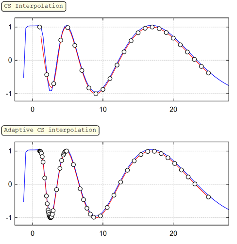

#8 Опубликовано: 31.08.2018 01:21:49
CSplines with adaptive steps. Same issues, but now can use zero with units, at least in the adaptive case.
adapt cspline test.sm (83,25 КиБ) скачан 1275 раз(а).

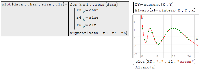

#13 Опубликовано: 02.09.2018 18:12:38
Derivative and integral for regular cubic splines.
1. I don't think you have any kind of spline for real application [added example].
2. From what I tested before Smath cinterp is universal [Matlab, Mathematica, Mathcad ...]
3. Read carefully: Smath ainterp [Akima] is unique to me to Smath.
From previous ad nauseum testing, it fits exceptionally well certain types of data
and is pure crap for other types of data, that's what it is. Superb for the example.
4. On the other hand, integrator supports cinterp, your coding does not.
The cumulative integration does between limits as well, just more greedy in time.
5. I don't understand all that crappy coding from download ... damned mystic !
All in all: most interesting. Thanks Alvaro.
di cspline test [SHORT] Copy.sm (104,62 КиБ) скачан 1124 раз(а).
