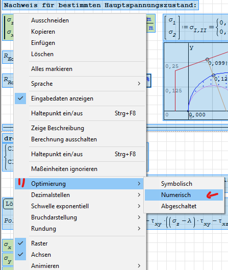

Whenever possible use 'numeric otpimization".
Just select everything (Ctrl A on Windows PC) and choose 'numeric otpimization". (Then eval is not needed necessarily.)
Takes only half a second in my PC. (Adding Ans:Ans, of course.)

Sorry, on Windows keyboards with English layout 'Ctrl + A' is the correct key to select the whole content of the sheet.
Then select from the context menu Optimization -> numeric.
Thanks. I discovered that and it really helped. For the test case mine ran for about 0.8 seconds. Your computer is faster than mine. Mine is five years old. It even runs for total time from 10-9 to 10-1 seconds with 30 points/decade and number of spatial cells = 10. The runtime for that case is about 2 minutes. If I increase the number of spatial cells to 100 it was still running at 1 hour.

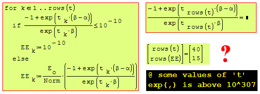

WroteOnce I get something that works
From other replies it seems working, but not Win 7 SS 6179.
The beta, alpha magnitude don't match the exp(,) wrt 't'
Maybe the beta, alpha got corrupted in the transmission ?
COUPLED Reg3[UKN].sm (92,25 КиБ) скачан 942 раз(а).

Okay, here is the Mathcad code that I should have started with before I wandered off into never-never-land. This handles the cable terminations correctly for shorts on both ends.
EXPLICIT TDFD DBL EXP DRIVER.pdf (120,53 КиБ) скачан 729 раз(а).
I don't know what I was thinking trying to define the terminations inside the difference equations. Perhaps it's doable; it's just not obvious to me right now.
Notice the run-time is only 12 seconds for 10^-9 <= t <= 10^-1 using 30 points per decade for a total of 240 time points. The number of spatial cells is 100. I am not sure I can approach that with SMath unless there is an alternate programming for the explicit TDFD. Implicit differencing should be faster, but I am not good at that. In fact, I am not sure I am even capable. When I retired I gave all my physics and math books away and started buying golf and fly fishing books.
A side note: In my day the correct spelling was kiloJoule and not kilojoule. The reason is Joule was a real person. Similarly it was kiloVolts, microAmps, etc. We just get no respect these days. :d
Reg
