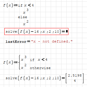

Update of statement:
solve(), roots(), FindRoot() doesn't like if() function.
However, they can solve when cases() used instead of if().

I have diagnosed the symptoms with solve bug.
Made a page about this and tried to explain with detail.

solve(), roots(), FindRoot() doesn't like if statement.
if/else was reported SS 5346.
Davide added if/otherwise SS 6179
Here some notes about my opinion of how to work with piecewise continuous functions.

#5 Опубликовано: 12.06.2021 15:24:02
IMHO, its logical solving piece wise discontinuous,
solve piece wise as well for productive classroom.
