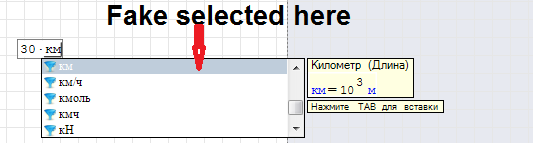

This is very old issue and i guiss its enough 1 row of code to fix it
the issue is following
For example,
i type "30" then type "км", get dropped listbox, then push enter. so i got км - неопределено
Then
i type "30" then type "км", get dropped listbox, then push arrowdown, then push arrowup, then push enter. so i got normal blue kilometers

Then list_box is dropped, zero item is seems to be selected. so if i leave entering enter, i expect my choice should been applied.
Anyway, what is the difference between "км" and "км" as dimension?
And why various items of list_box requires various actions: double-click on zero item and push arrow buttons for the rest items (much more comfortable, because i have not grab the mouse and double-click on item already chosen)

it is very inconvenient when buttons are redefined in an unusual way because muscle memory is shaped according to patterns used in other more traditional applications, which are used much more often. Therefore, a desire automatically arises to press Enter, despite the prompt to press Tab. Moreover, the Tab button is much smaller and is located on the left, that is, on the side of the weak hand. For me, for example, it is much easier, more convenient and faster to press the down arrow, up arrow and Enter than to look for the tab button on the keyboard.
Finally, if you type 30km, then down arrow right arrow, what should happen? I think nothing should happen, but there is a loss of focus and an undefined value of km. What if I just type "30 km ="? I get km - undefined. Why do I have to choose from the list every time I enter a dimension ???
In general, to be honest, because of this small oversight, all my impression of the program as a whole is blurred.
By the way, I took 4 random IDEs that support auto-completion. In two of them the tab button did not work at all, in two it worked the same way as Enter. For example, in SharpDevelop, the tab button works like Esc, because the zero element is not selected. but if you select any item, then it works like an Enter. Because the Enter button is usually used to execute the default function and not to "leave focus from region". Just the Tab button shifts the focus to another control.

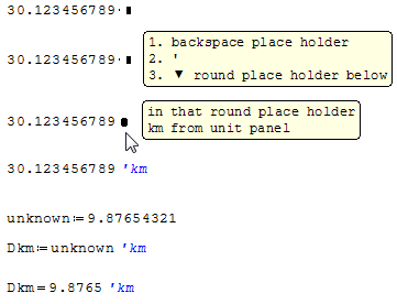

... What if I just type "30 km ="? I get km - undefined. Why do I have to choose from the list every time I enter a dimension ???
Just because you want. You can choose to directly type "30'km="
(Notice the ' character)

I just want to type
V:=30km[arrow_right]/10min= # ignore popup
or
Скорость:=30км[arrow_right]/10мин= # ignore popup
or (with selecting item of popup by k/b )
V:=30km[Enter][arrow_right]/10min= #problem is no 'km' in smath, but should be?????
Скорость:=30км[Enter][arrow_right]/10мин= #fist item seems to be already selected, but in fact not
and get the result but not the error message of undefined type 'km' оr 'км', which should be defined
I want to get the result w/o using mouse or any other pointer. just keyboard
Seems like km disappeared from smath =(
I guiss all extensions should be English. all localized extensions should be pseudos of english names.
It should be setting of displaying only english, only localized or both extensions
Interesting thought actually. It seems I need either to:
  1. show selection only if written text is exactly the same as shown in the list;
  2. replace written text with the one selected in the list as soon as list is closed (even if no Tab or Enter pressed).
Seems reasonable, I will handle it soon.
