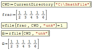

Hi Everybody,
I am trying to export (i.e., write to a text file) a vector of decimal numbers. With wfile function, I am only able to get fractional representation of data available. Is it possible to export numbers in decimal format only or should I convert them in Excel manually at the moment?
I will appreciate any other suggestion (other plugin or function) as an alternative.

You can use the "Data Exchange" plugin -> "ExportData.CSV" function

WroteYou can use the "Data Exchange" plugin -> "ExportData.CSV" function
Solved. Many Thanks Sergio
