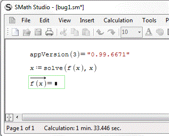

Try to reproduce this, please.
This is the attached file bug.sm (4,41 КиБ) скачан 1268 раз(а).
Now, disable the function definition
f(x) vectorized will get stuck.

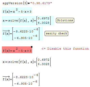

#2 Опубликовано: 08.07.2018 11:09:58
Not a bug, very many different calculated results are stored.
That is very handy ... example: images
The "rainbow ColorMap Electron" is there as you open the work sheet.
Image Rainbow Colormap [Electron].sm (252,09 КиБ) скачан 1113 раз(а).

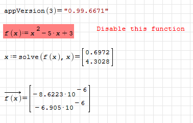

#3 Опубликовано: 08.07.2018 17:53:25
I think Radovan just wanted to indicate a malfunction when the function is disabled and the subsequent vectorization on the function goes into an infinite loop.
I think he was expecting a non-evaluation (I was expecting it too)

#4 Опубликовано: 08.07.2018 18:54:50
It does not go into an infinite loop.
Once assigned, result of vector/matrix is resident as an identity to the project.
No matter if disabled afterwards, calculated and stored.
This feature is one of my preferred vs Mathcad.

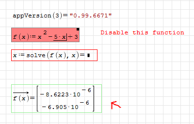

I'll have to get back to my first post
Function f(x) was not defined. What is going on then? Why the calculation did not stop with an error issued? If you wait enough it can crash SMath. I reproduced that on few computers and suspect this might be a bug or a problem. That was my question.
#10 Опубликовано: 09.07.2018 10:31:49
For sure, if you wait too long before [Shift+Esc] it will crash Smath,
because it enters an infinite loop. That answers your question ! bug !
When entering an infinite loop there should be an error message/stop calculate.
Caution: if you figure you have entered an infinite loop stop,stop,stop ...
it will crash Smath and zap the document "root element missing" => 0kB
All that from true story !
