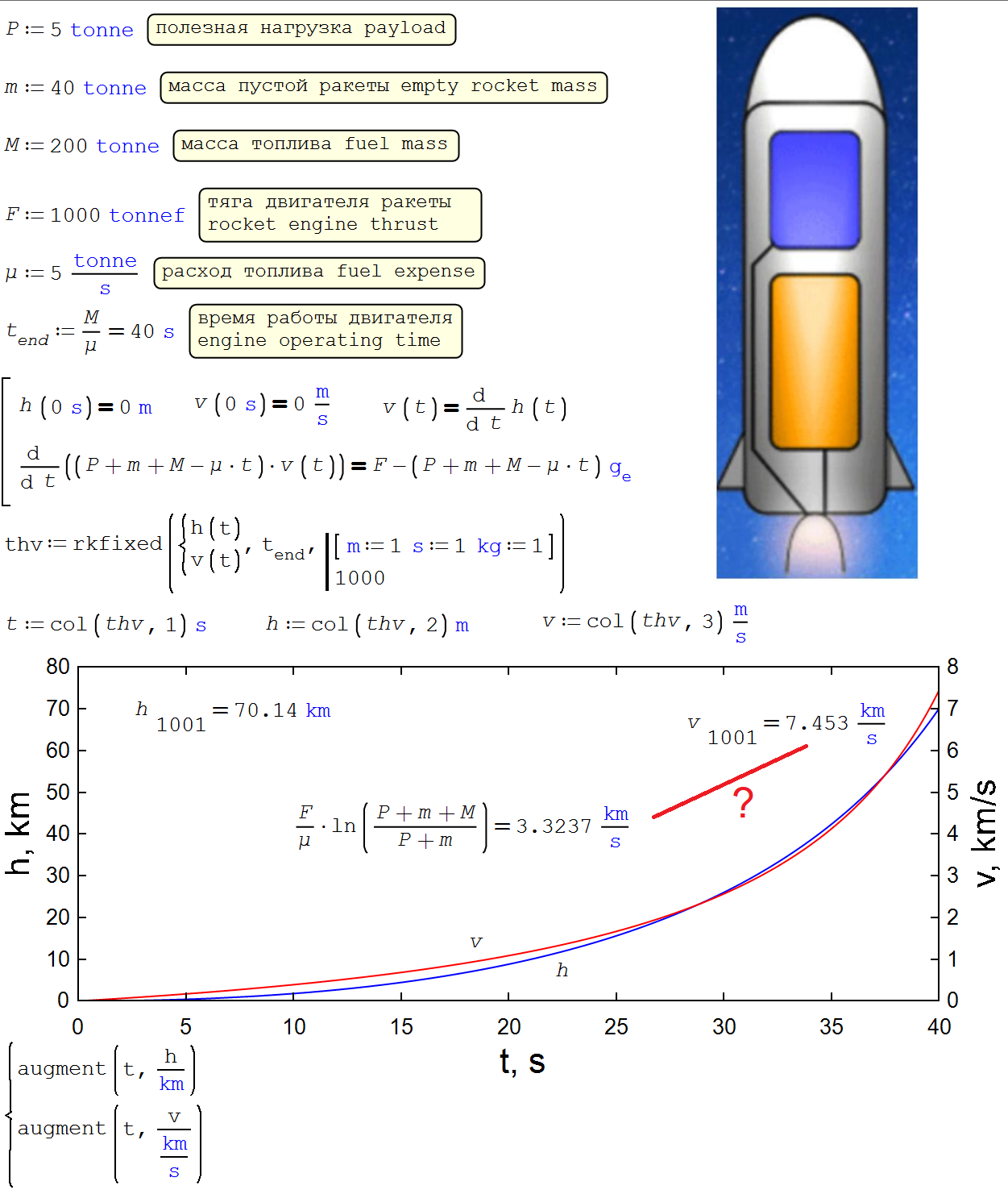

Error by ODEs solution - Help please - Сообщения
Here not OK Rocket-2.sm (688,11 КиБ) скачан 1378 раз(а).
About the problem Study-24-How-calculate-Rocket.doc (1,95 МиБ) скачан 804 раз(а).
from the book

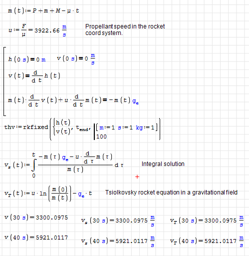

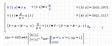

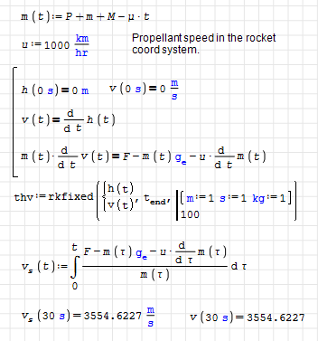

But Newton's second law is not F=ma which is an expression valid only for systems where m is constant. The general expression given by Newton is F=d(mv)/dt or F=dp/dt with p=mv the linear momentum.
WroteHi Valery. Just use cases() instead if() clauses.
Thanks, Alvaro!
One questions.
How can we solve this problem with ODE as F=dp/dt, not F=m dv/dt?
Will we get others (numerical) answer?
Rocket-2-otherwise.sm (690,02 КиБ) скачан 1379 раз(а).
Rocket-1.sm (20,07 КиБ) скачан 1355 раз(а).

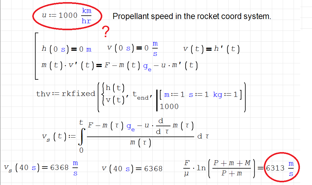

Another way of looking at it, using the equation F = d(mv)/dt, we must take into account that in a rocket the reaction force is not applied to the same body as the action force, as the 3rd Law says, and therefore the temporal derivative of the product mv must be done by changing the reference frame, which is why it is F = m dv/dt + u dm/dt, where v is the speed of the rocket with respect to the inertial reference system attached to the earth, but u is the speed of the propellant with respect to the non-inertial reference system attached to the rocket
WroteNew question...
Hi Valery. You can't take the temporal derivative directly. Please see my previous answer explaining why I think that.
WroteWroteNew question...

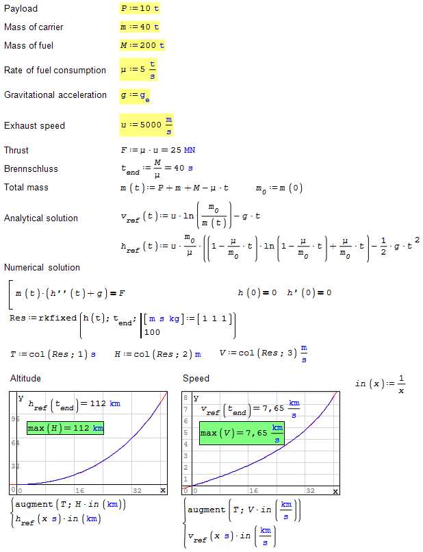

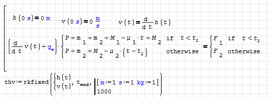

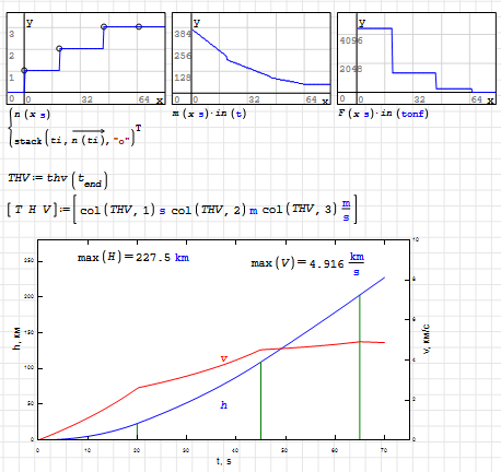

And what about the 2-stage rocket?
Our first try
Rocket-2.sm (690,02 КиБ) скачан 1445 раз(а).
Wrote...
Our first try
Hi. Your original solution for rocket-1 is ok, and that implies that the movie's solution is also ok.
I was only pointing out the way to deduce it. Writing the relationship for several stages would imply asking for derivatives for functions with cases(), which cannot be done, because although functions can be integrated with cases() or using inside the Mathcad block, they definitely cannot be derived.
So I guess the best solution is the one you gave at the beginning, simply replacing the if() with cases(). The deduction based on physical principles has already been done for one stage. Now it remains to apply the simplified result for several, which is exactly what the rocket-2 case does.

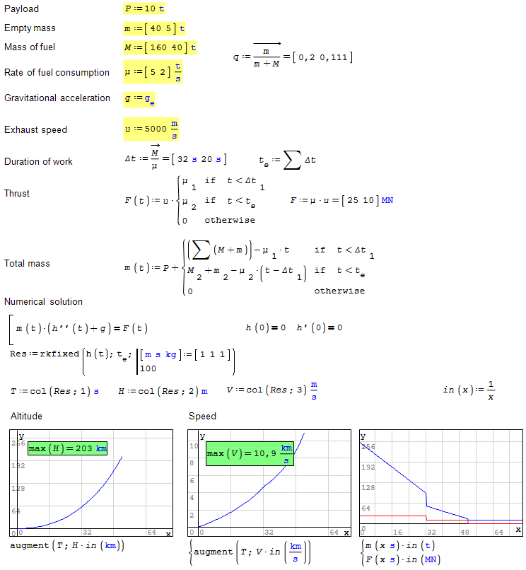

Rakete.sm (21,1 КиБ) скачан 1357 раз(а).
Rakete2.sm (21,45 КиБ) скачан 1405 раз(а).
Martin, Rasonar!
Would you like to be coauthors?
See please attach
Polet na Lunu.docx (585,34 КиБ) скачан 733 раз(а).
Rakete-1.sm (16,31 КиБ) скачан 1353 раз(а).
Rakete-2.sm (17,18 КиБ) скачан 1372 раз(а).

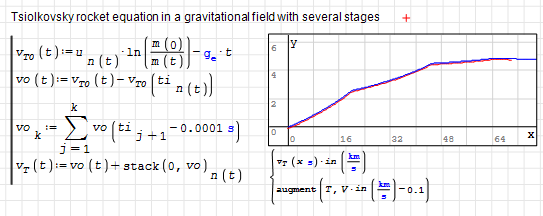

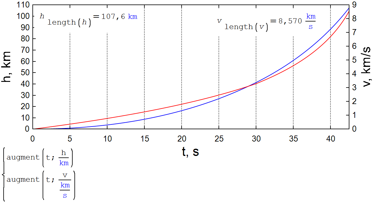

Checking with Tsiolkovsky rocket equation in a gravitational field with several stages
Rakete-3.sm (46,49 КиБ) скачан 1413 раз(а).
