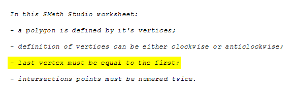

#7 Опубликовано: 01.07.2019 05:29:57
Does it work as well for open polygon ?
Nope, this worksheet was made just for closed polygons.
