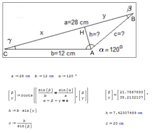

Do you know more simple method?
Natasha-Units.sm (147,18 КиБ) скачан 1442 раз(а).

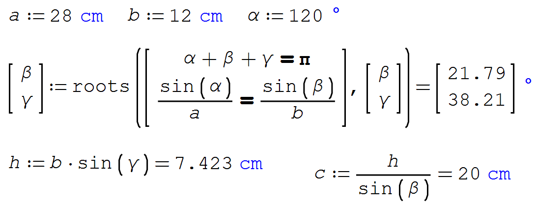

FindRoot() can be a simpler method.
You can auto assign guesses to unknowns.
And it can solve with units.
Natasha-Units_findroot.sm (114,03 КиБ) скачан 1442 раз(а).

Here's a simple method:
