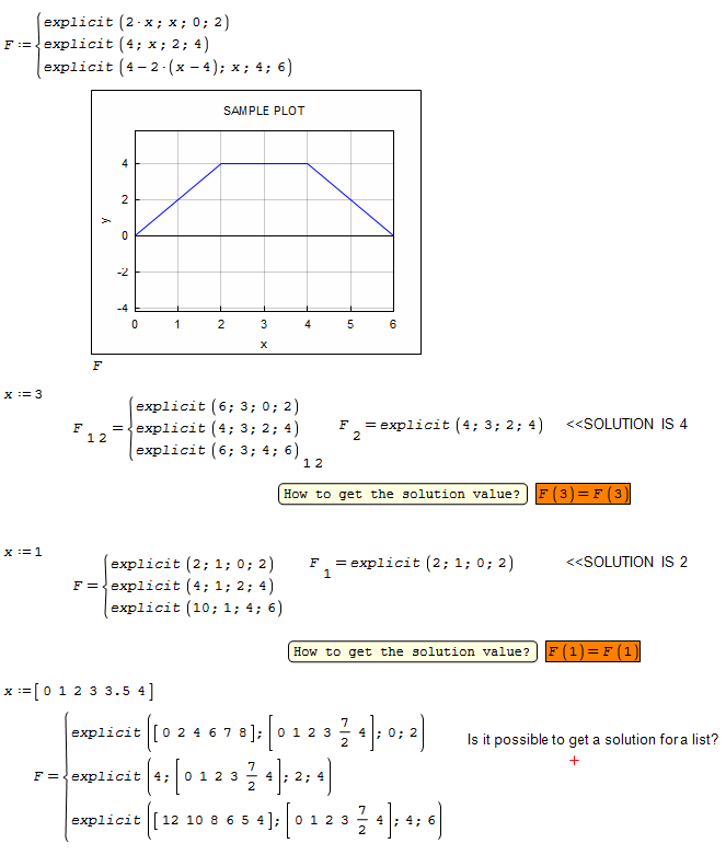

Hello, could you help me?
is there a function in wxMaxima that allows extracting solutions for a composite function?
Hoja de trabajo13.sm (23,87 КиБ) скачан 1025 раз(а).

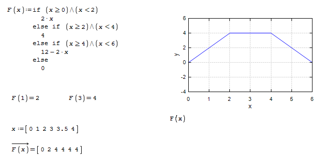

Why not simply:
oscar mauricio 10.09.2024 08:10:00

Thanks @StvMath. The proposed solution is more appropriate for the proposed example, the question was asked in a simple way so as not to present a complex code to whoever could help me.
I need to give a solution to the question because I was analyzing a code published by @mkraska years ago, the code described is more complex and requires a solution with the Maxima plugin. I am also interested in learning Maxima and I think that the solution written by Martin is a very useful way to develop some functions.
"https://en.smath.com/forum/yaf_postst2447_SMath-For-Engineering-Calculations.aspx"

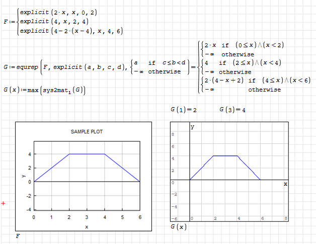

#4 Опубликовано: 11.09.2024 22:18:01
1 080 сообщений из 1 752 понравились пользователям.
Hi. This could be a way.
Hoja de trabajo13.sm (28,5 КиБ) скачан 1050 раз(а).
