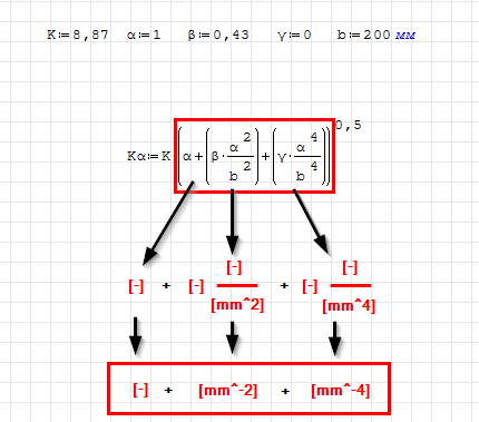

Maybe the attached picture helps a little bit more to understand the issue...
As stated previously, you can't sum apples and oranges; therefore the error message seems consistent...
![2015-02-02 23_58_30-SMath Studio Desktop - [Page1_].png](/ru-RU/files/Download/NK2ohY/2015-02-02-23_58_30-SMath-Studio-Desktop---[Page1_].png)

Thanks for sharing the original formula, this makes more sense; seems you have missed or merged a parameter (alpha) with a variable (a)

Seems strange, because in this way the formula has both mathematical sense (alpha*x^0+beta*x^2+gamma*x^4) and physical sense (homogenous units involved in the calculation)... there is some literature about this formula? (where it is used? has an author?)
